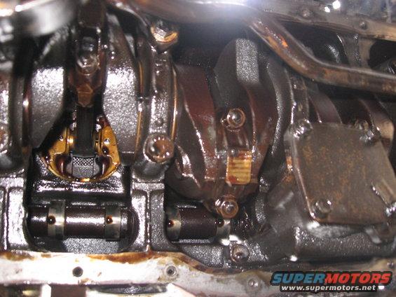

A picture I took of the inside of my engine from underneath.
I've never removed a piston, so I don't know what's entailed in the job, but just looking at the picture, it doesn't look like it could be removed without dropping the whole crankshaft out from underneath the engine to make room for it.

Sorry to say you won't get it out,the webs which support the mainsare narrower than the piston diameter. If you were able too get it out how are you going to get it back into the bore? No straight surface to guide the compressed rings back into it. Kotzy

Pistons have to come out through the top on most engines, the 300 is no exception. There is only about 3" of space between the main bearing webs.
