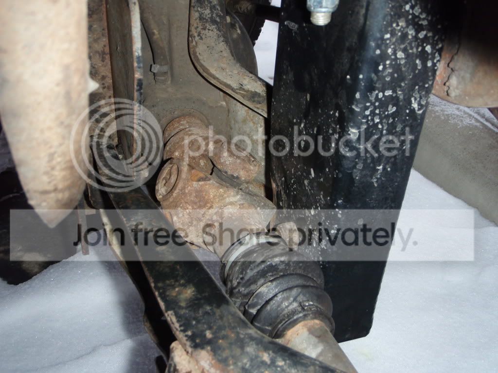

Not too much movement in the joints. However i think i found my problem....
The ujoint is rubbing the drop bracket when the shaft is spinning.
