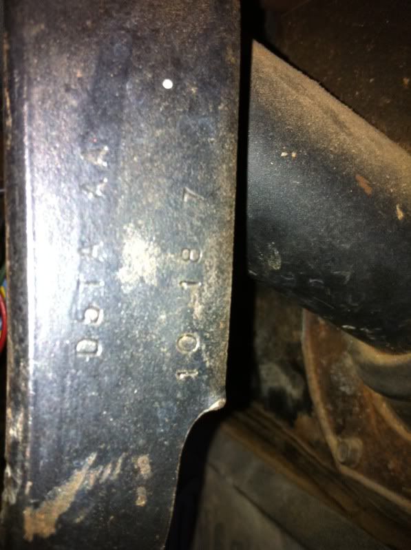

Here's a photo of the pedal in case for whatever reason it has been changed...
I Notice it says d5ta instead of d3tz. Is that relevant?

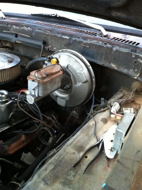

Nevermind, I think I found it. Pepboys carries it as OE Part number D5TZ 2005-B It looks identical to the one I pulled. I'm going to order it and see what happens. Wish me luck...

The pedal is from Oct 18 1977
That D5TZ- 2005-B interchanges with Bendix 10468 like I stated from the start

And there it is...
Tons of thanks to steponit and numberdummy...
