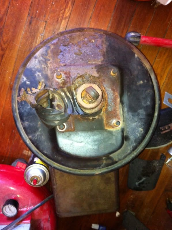

So I finally got some time today to tear into the next step in my brake system rebuild and pulled the brake booster off. As I suspected, there is cancer eating through the back of the booster and I believe that to be where my brake woes are coming from.
Anyways. I called up Pepboys and they said there were several different boosters and that I needed the pushrod code. I've looked all over the thing and can only find the number 23 and "made in canada" stamped on it. Any ideas of where to look? Does it really matter?

There is an D-23 and an F-23
What is the model of your truck ?
I found that a Bendix Booster # 10468 applies to a 73-76 F100 4x2 and 4x4 crosses to FT-17
are you sure about #23 ?

what are the last 6 digits of the Vin#
Possible Ford number for 76 F100 4x4 is D3TZ-2005-A
can you photograph that part of the booster and post it so I can see it for myself ?

Pushrod Photo
Pushrod
Booster Backside
VIN- F11YUA78944

Several different boosters?
1973/79 F100/350: There are TWENTY TWO different brake pedals, SEVEN different clutch pedals and NINETEEN different P/B boosters...I kid you not.
You have to match the booster to whatever brake pedal the truck has. Ford stamped an ID number on the brake pedal. Look at the pedal, and post the ID number from it. One example of 22: D3TA-2455-AA.
Otherwise you are going to be in a world of hurt...trying to match parts that were not matched originally.
If you post the pedal ID number, I can match it to the correct booster, then list the Ford part number.
stepoinit may have a way to cross the Ford part number to the autoparts store booster ID number, then you can get the correct booster from the parts store.

That 23 is on the fulcrum not the booster
Look on the pushrod coming out of the booster.
On the last picture
Look between the eyelet on the pushrod and the booster itself
It should be cast or stamped into the rod
look for FT-17

Originally Posted by Jeepers2003
So the number is on the pedal itself? I'm confused.
Ford sez: The brake pedal ID number must be known to get the correct booster.
I need the ID number that is stamped on the brake pedal. One example of 22: D3TA-2455-AA.
This has nothing to do with any code for the pushrod...because there isn't any such thing listed in Ford parts catalogs.

I was just contacted by Mil1ion ( the guy with all the photos)
He says your pedal should be stamped D3TA-CA
On the front flat area of the booster, below where the MC mounts there should be a 5 digit number stamped into the metal as well
He said look for the FT# on either side of the rod shown here

OK, there are NO markings on the pushrod itself. There is a marking 303 A on the booster body. Any use for that?

Then look for the stamping on the brake pedal or a tag on the booster

Anytime I ever bought a booster (from a Ford dealer) they always work off the serial number to order the new one.
