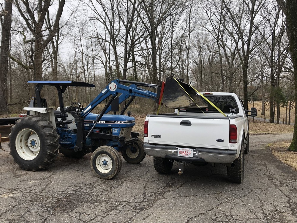

Said Blue Bronco 95, “Easy way to remove bed.”
Bradford Built Mounted Flatbed How to
Perfect clean removal.

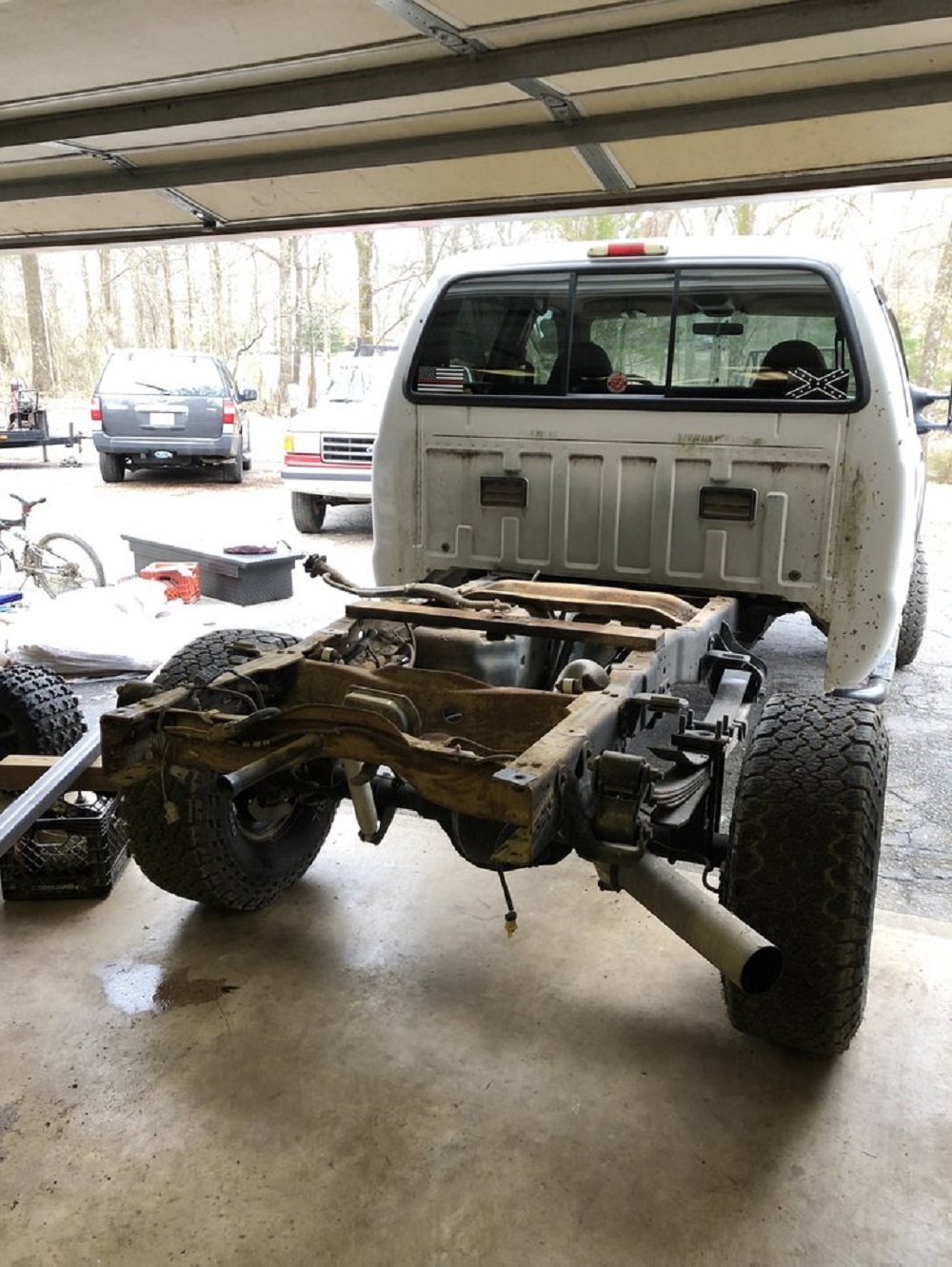

Next cutting, measuring and assembling.
Cut to 45” truck frame is 38.5” and flatbed is 41.5. Measure hole widths in frame, and drilled with step bit to accept 5/8” grade 8 bolts with lock nuts. It’s hard to see but I made some 3/16 steel spacers from flatstock to space the two runners the correct height.

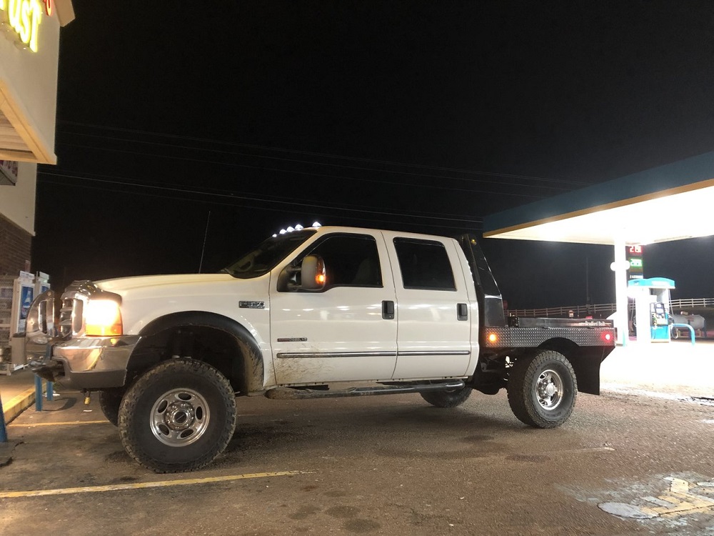

The finished product looks sturdy and badass.

Test drive after mounting it to go get more beer.
