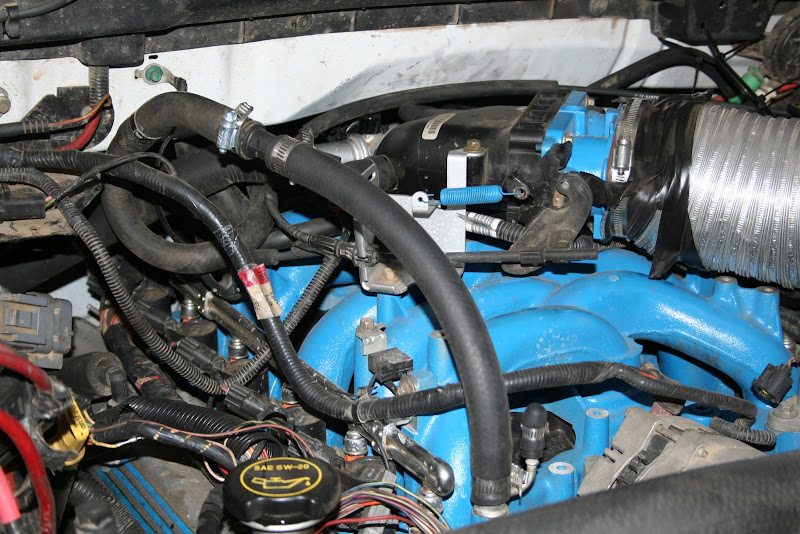

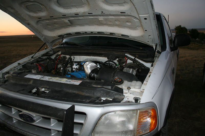

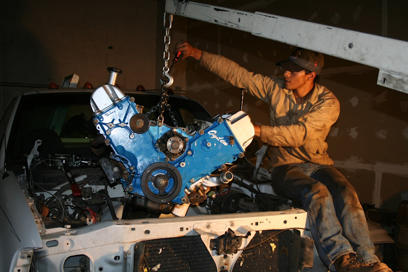

I just finished installing a performance built Triton V-10 into my 1999 F250 LD and I thought you all might like to see. I've been having lots of fun driving it around and its getting about 18 mpg!

Tight squeeze?

Yeah, it was a pretty tight fit, I did manage to keep the stock cooling fan though.

I wonder if I could get one to fit in my wife's Expedition.
How long did the swap take? What about wiring? Plug and play or snip and splice?

I love swaps! Get rid of the dryer tubing.

Thanks for all of your replies! The drier tubing is VERY VERY temoprary, I just have it there while I think of a way to fabricate a better intake tube setup. As far as the whole swap went, I spent close to a year doing prep work finding all of the parts and building the engine. Then I completed the swap in about eight days. The mechanical side of it went fairly smoothly, however the wiring has been a headache. Lots of "snipping and splicing"

yea the dryer duct and tape are ruining an other wise awesoem engine swap..
ur MPG is to die for to...
