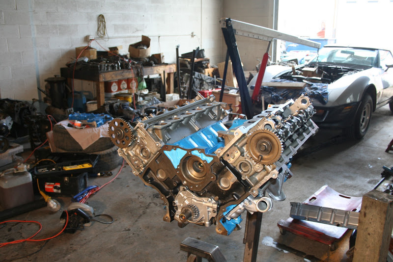

Ehhh...okay, I'm starting to see it become more and more possible.
What kind of work did you have done to the engine proper, OP?

I would like to know whats been done to it.
Looks great!

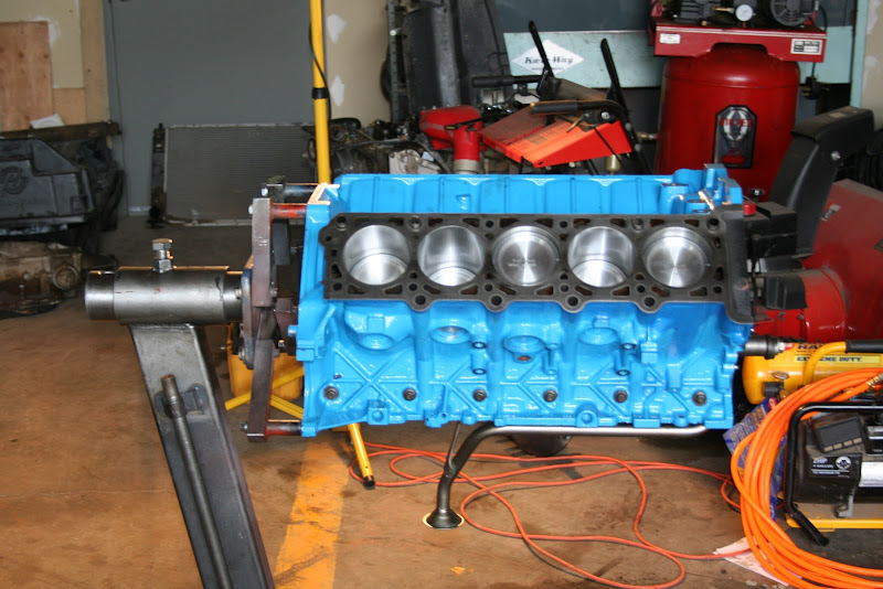

By saying performance built, I mean that the V10 is bored 50 over, I have ported heads, an 11:1 compression ratio (shallow dish pistons, decked block), Forged Aluminum Pistons, and a crankshaft balanced to .01 grams for that extra smooth idle

Very nice! I have a V10 sitting around I either need to sell or do something with...maybe a standard cab short bed 2x F150. My wife is going to kill me!
That would do it.

Who made the engine stand? ...very nice work!

In case the photo hosting site ever loses those pictures, I've attached them here at FTE. I can imagine people 5 years from now asking "what happened to the pics"
