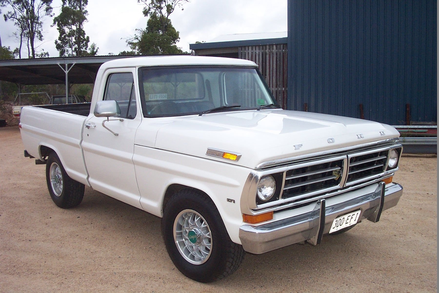

240 carb head onto 300 EFI??
[QUOTE=8525ford;9201124]get a cylinder head from a 240 engine, those have smaller combustion chambers which will raise your compression up a good bit. find the head take it to the machine shop have them mag it and do a good valve job replace the seals and guides and you should have some good power outta that head. Dont know how high the compression would be or if you would need to run premium, i would doubt it but im sure someone else would chime in and give you a heads up on that.
So, let me make sure I've got this right. Whip off the 300 EFI head and fit a 240 carb unit which I spare lying around. That will obviously up the compression. Do I need anything else. I mean, could it be that simple for some bolt on additional HP? I already have a nice mild towing cam. Do I need to muck around with push rods or anything? How about the port match to EFI inlet and headers?

I loved my '72 Daughter. SIL came along and made me an offer I couldn't refuse.

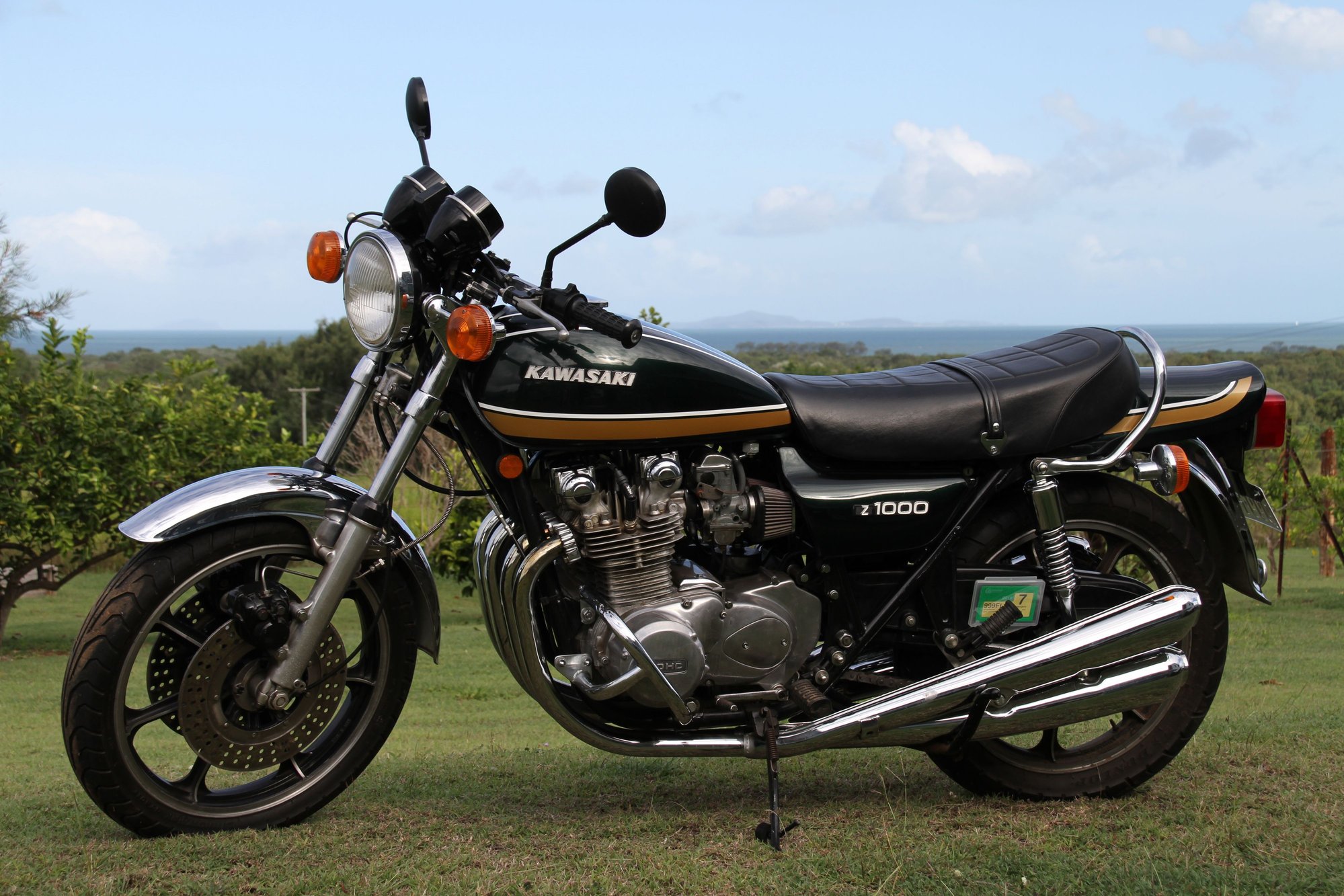

I had a 1974 Z1 900 Kawasaki back in the day. I also had a 1977 KZ1000 Rickman with a supercharger.
Is your KZ1000 stock?
Hi. I can't remember the specs of the cam. I switched it a few years ago along with steel timing gears. They are noisy so I plumbed a line directly from the pump to the timing case just to shut it up a bit.
So the yarn about improved performance from a 240 head is just a myth then? I won't go to the trouble. Thanks for the tip.
G.P.
I bought this in 1978 when I was just 23. I'm now 65.
Very stock Z1000. Fitted 900 4 into 4 exhaust just because it looks better.

Beautiful bike BTW.

Very nice looking truck.
As FTF replied, the 1965 to 1986 300s had the 76cc chamber volume and compression could be raised by replacing with the 240 head.
The 1987 and later EFI engines like yours have a 69cc chamber so no help in compression from a 240 head.
Beautiful Kawasaki!
What alloy wheels are those?
Beautiful Kawasaki!
Factory standard alloy rims.
