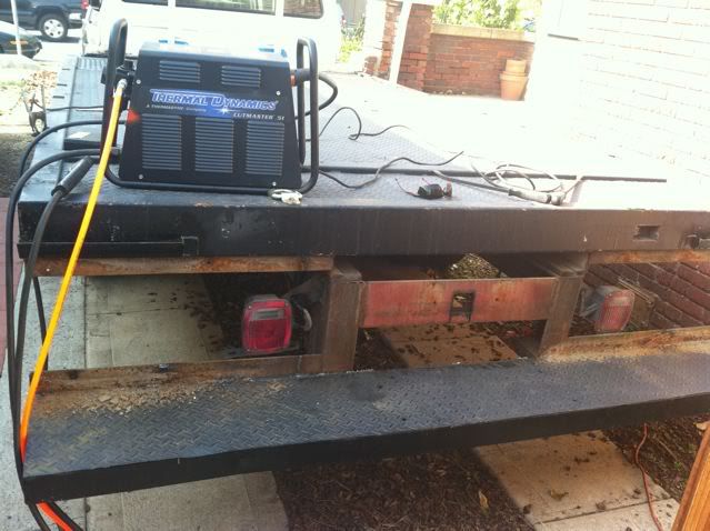

Got back to doing some mods....

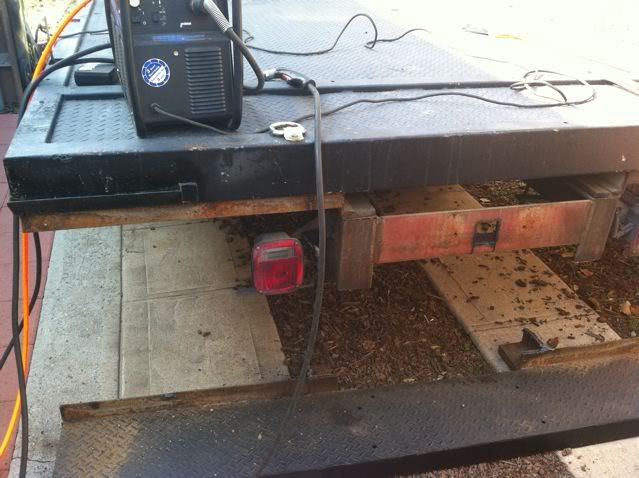

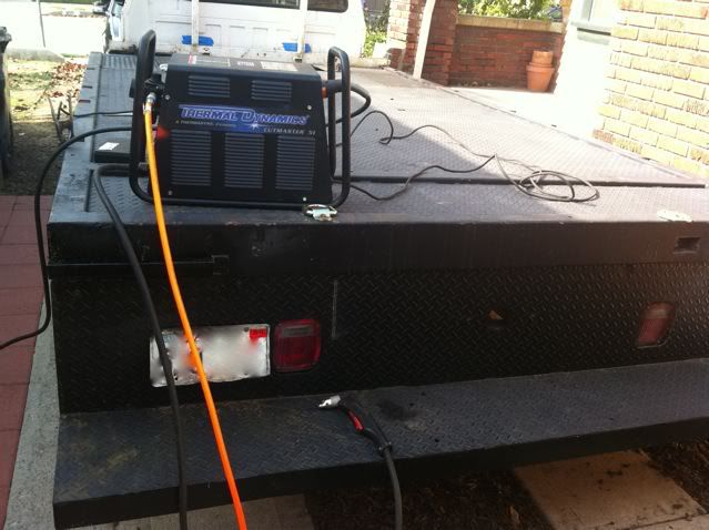

This rear tail added useless length, really hurt the departure angle even in my driveway and could be a hazard to other cars when I'm backing up...
It had to go... Setting up for removal.
Got the back plate off to expose the supports....
It wasn't until I cut through the supports that I realized how thick they were...

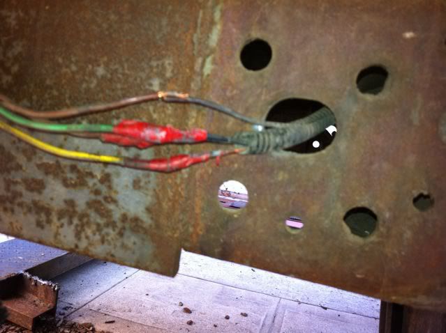

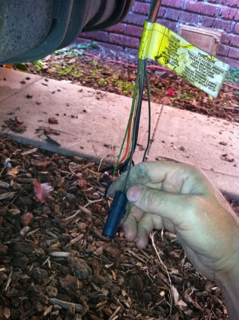

While I was down there I unwrapped the wiring to the rear tail lights, something didn't look quite right. All the connections were just twisted together...

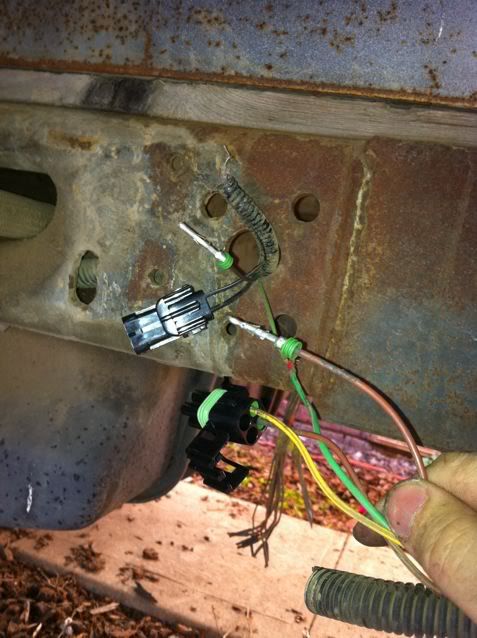

I pulled out my new favorite set of tools... Weatherpak tools and a BUNCH of connectors...

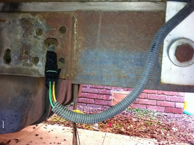

Here's one side done. Love these connectors, factory appearance, weathertight and positive locking...

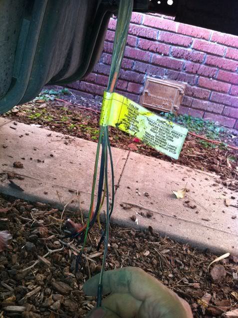

I pulled down the trailer wiring and am going to wire in for better running lights along the sides of the bed. Turns out they weren't even hooked up although rigid conduit was run to all of them under the flatbed. Here's the trailer running light wire:
Single wire weatherpak connector installed, was thinking of grounding each light individually:
