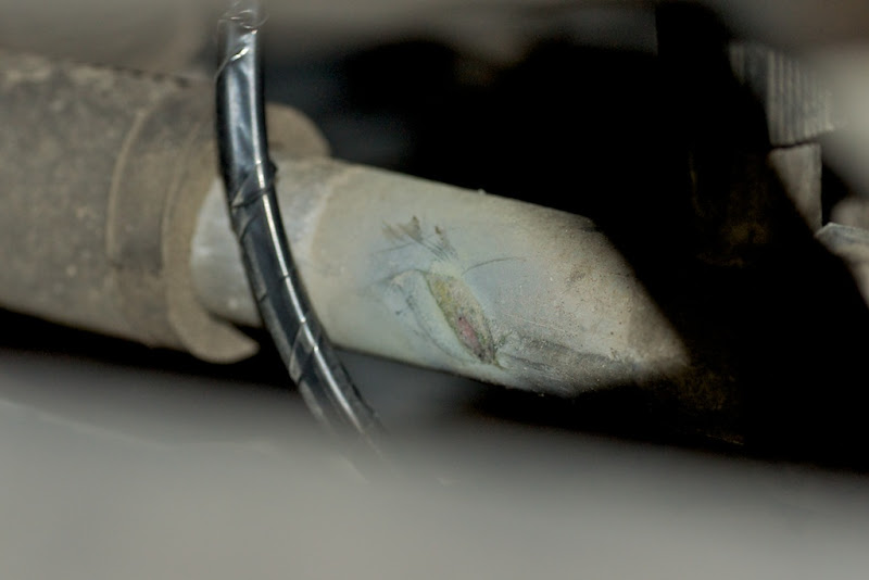

I've been getting intermittent stalls (from several times a day to months between occurrences), and always throwing P0320. Dealer replaced all spark plugs and at least one coil. Crankshaft sensor was just replaced. Still intermittently stalls .
I ordered the Alternator harness as described in your post and TSB. Unfortunately it's not available locally and needs to be brought in from the USA. So while waiting for this part to arrive, tonight I decided to check it out for the chaffing mentioned in the TSB.
Well I found it. On the alternator harness with this lead that connects just to the right of the battery (viewing from the front of the truck).
The cable runs over one of the metal A/C piping. Note the scoring on the pipe to the right of the cable.
Wow, it wore right through the insulation and some of the wire strands are worn through as well.
I guess all the rubbing and possible arcing has actually wore a gouge into the metal A/C tubing.
Until the replacement cable arrives, I patched up the harness with electrical tape and put some around the around the metal A/C tubing as well. Took the vehicle for a drive (about 2.5hrs). So far so good. Hopefully it was just this the whole time.

Wow! I'll have to take a look at mine and see if I have the same marks on the A/C tubing. It sucks if that's the real cause of the problem as it sounds like both of us have spent a fair amount of $$$ chasing this thing. Good luck!
I'm having the same problem, and I'm wondering if replacing this wire worked for you? Thanks for the pictures!
