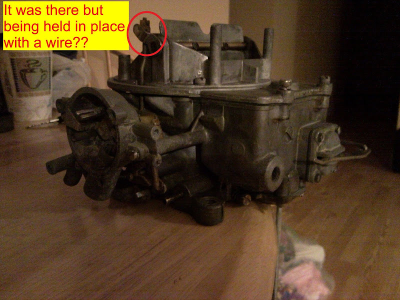

Blah, the spring inside my choke housing is broke... is this a difficult find? I was able to get it to "slide" back in under what was still attached in the center, is this still usable? I'll get a pic on later when I have my camera charged.

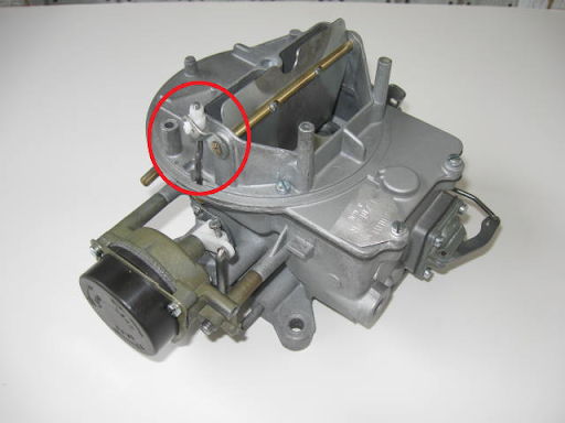

Also I'm missing the part circled in read, almost looks like a paper clip is being used. Is that going to be in the kit?

that maybe part of the choke.I cann't remember if there is new parts for that in the reduild kit.There is like 6 screws on the top of the carb that hold the top onand the stud that holds the air cleaner on. take them out and twist the top around the choke rod and you can see the fuel bowl and float the float has a spring clip that holds it on to the main jet housing you can unclip it and check your main jet for blockage it will be a 3/8 socket and check the float out to see if it floats also the jets are in there 2 of them a large flat blade screwdriver to take them out and clean watch when reinsalling not to over tighten these items.I would just wire the choke butterfly open for now.There is alot of parts that all the 2100 share there was changes made to the base shape where they bolt to manifold. Also welcome to the site

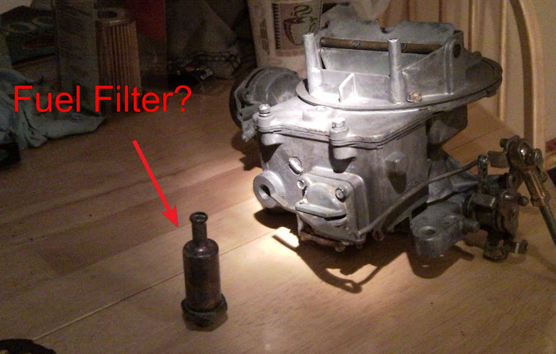

Thanks for all the input guys. I know the pumps working, I had my wife turning it over while I watched and saw fuel spraying out of the short rubber(?) fuel line that was connected to the carb at a brass(?) fitting and to a solid line on the other end. I have a question about that fitting, it was leaking as well next to the carb, is it just an adapter or is it a filter? I just finished cleaning everything and if it's a filter I want to replace it, not just screw it back on. And either way, to prevent it from leaking there should I use some thread tape(plumbers tape), or something similar?

yes that is your fuel filter.

Quick question, my fuel filter doesn't seem to be threading on straight, I haven't forced it but I do recall fuel was leaking from around that hole when I was trying to start it before doing a rebuild. At the risk of ruining it, would using some plumbers tape and wrenching it on the rest of the way be acceptable? I don't want it to leak, and I can't afford to have it re-threaded.

Two fuel filters are available that look the same, but have different threads. Make sure you get the correct one, hopefully the carb hasn't had a wrong one forced in there.

Never use teflon tape on a fuel line fitting. It WILL deteriorate and get into the lines.
The best product I've found (and have been using for over 30 years) is Loctite PST (Pipe Sealant w/Teflon). It's like a paste that you put on the male threads.
