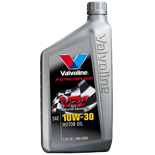

would this be good?
Product Features
  • High performance and protection for today's engines that run at high RPM
  • New ashless anti-wear additives combined with ZDDP provide ultimate wear protection
  • Enhanced anti-foam system helps protect the engine even during extreme stress
  • Enhanced additives protect against high-temperature deposits for a cleaner engine
  • Friction modifiers help improve horsepower output
