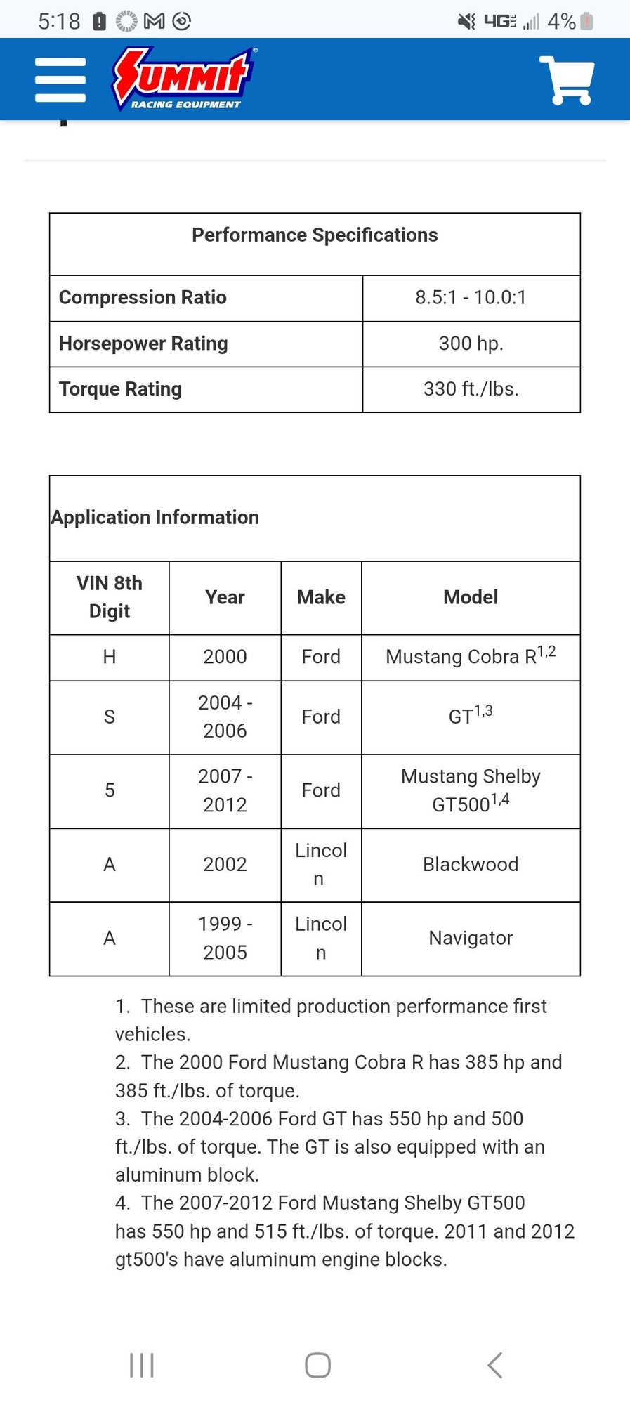

Originally Posted by Johnny Langton
Won't work unless you get the GT cylinder heads. They're completely different than any other DOHC head.
JL
This is what i would like to be informed to if i wanted to know what is what
