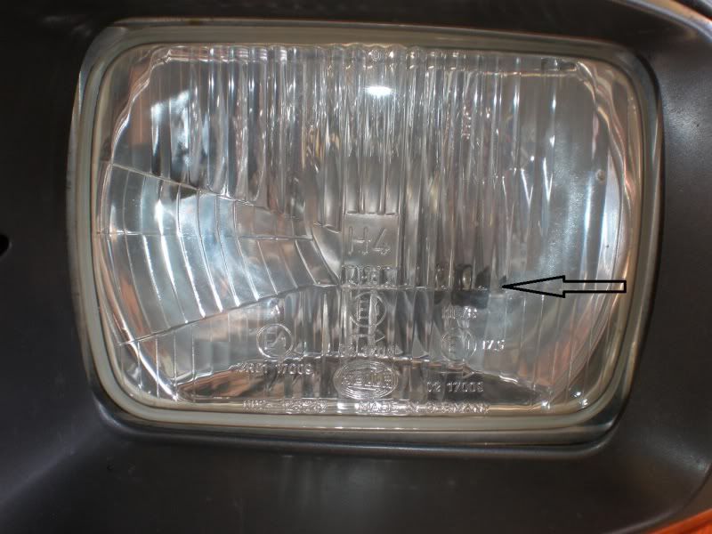

Park light bulb access
Thats we call it anyways. The small bulb in the head light. How the hell do you get it out ????

This one here. Im assuming its one of those push in ones like the one under the hood

That looks like a seald beam unit on say an XL model truck......may be an aftermarket at that........you may want to check but it looks to me as if someone has swapped those into your truck, I think you'll still have a completely separate parking/turn light just below what you are showing us.

There is a long rectangular one below which is orange and is used as a indicator. I willl take the light out and have a look. I know you can replace the low/high beam globe so Im assuming the park light globe is replaceable.

No. Those style of bulbs are seated in, held down with the outer ring that is held down with 4 little screws, two top, two bottom.
VERY easy to change a bulb.

I just realized hes in Australia......may be the requirements for lighting are different there??-I still say its an XL model with the old-fashioned glass sealed beams.....please let us know what you find.....

Dan wins it. Un do the two top an two bottom and the light comes out. The park light globe is in the bottom right of the light (when looking straight at it). Its just a slip in socket (rubber gromet) All lights are working. Thanks all
