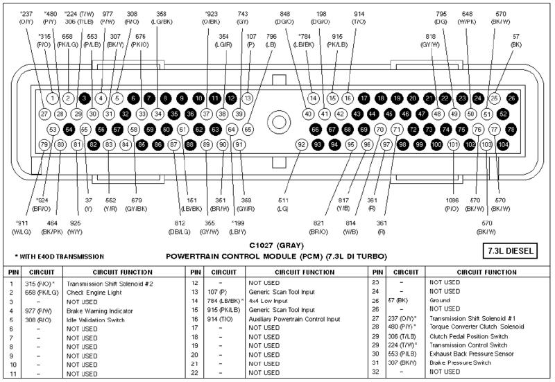

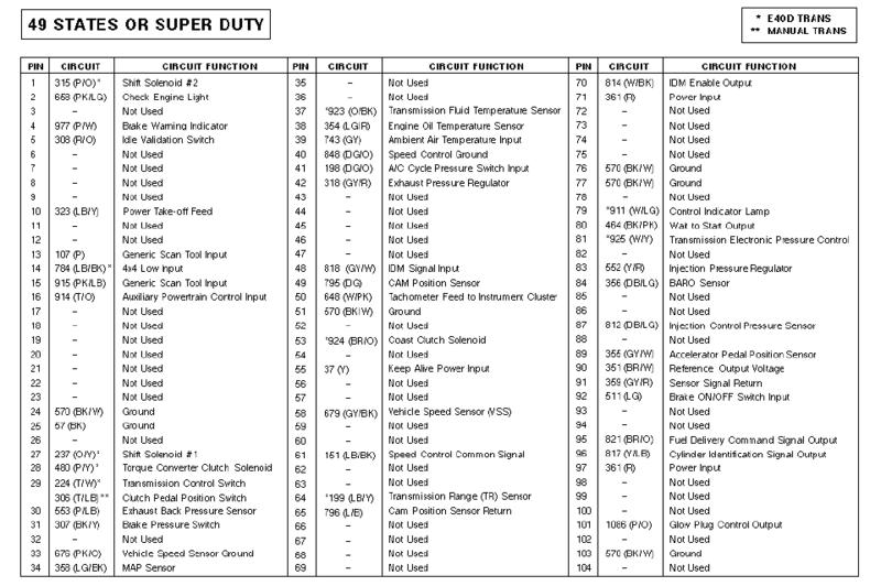

Has the wiring to the ICP been repaired yet ?...
The 725 is what is expected if the ICP was unplugged .. May want to recheck the wiring
Pin 90 looks to be ref voltage to all sensors
Attachment 24554
Attachment 24555
Good one Rick
