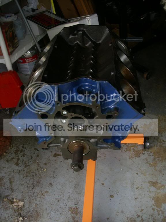

I am currently looking to build a 351w. I got a block that was suppose to have been freshly rebuilt, but I am unsure. It's a 1974 block according to the casting ID. I will probably break it down and rebuild it. Here it is below
OK enough of it
So my question is does this block look good?

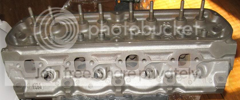

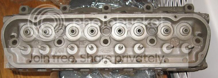

I bought some D0oE heads which are here below
OK so there's the heads, anyone see anything wrong? Will these work for my motor?

That's looks great to me, you got a stock rebuilt bottom end and you need valves and maybe some work on the heads to make them unleaded compatable, but otherwise it should all work just fine.. and make really good power.
As Conanski posted, you will have to have hardened valve seats installed in these heads
to make them compatible with unleaded fuel. Also look at how small the exhaust ports
are on these heads. They are the same size as 289/302 ports. Some good porting
work on the exhaust ports really helps performance.

You may want to go with some different heads...price what it will cost to get those up and going and compare some aftermarket or used gt40's. I ran D0OE's without hardened seats and they lasted less than 10k miles
This is always good advice, especially since you can have professionally ported E7's with valves and springs installed for about $600/pr from Powerheads or Thumper Performance.
I also have a 1984 351w from a full size ford according to ID, probably econoline. Will the heads off that work? Would it be better to use those or would I get more power from the D0oe heads? When you say hardened valve seat, will the ones that I have with the comp-cam kit not work? What would I have to do to get them to run unleaded? I have never done this before, but my dad rebuilds chevy motors, so I think with his help I can do this. What all do I need and what do I need to do?
Your Comp cams kit does not have valve seats in it.. it could have valve seals though. Installing seats is something that a machine shop will have to do, along with new guides and such, and that's what we're talking about when we say.. "get an estimate on how much it's going to cost to have these heads made ready to use", it will be this machine work plus the cost of valves and springs, and locks and retainers. Then compare that to the cost of ready-to-go heads from one of the vendors I mentioned above, and factor in that they will be professionally ported and will outflow your D0OE heads by quite a bit, and you start to see why it's usually better value to buy heads than build them.
Your '84 heads are smog era castings with larger combustion chambers so they're almost the worst head Ford ever made.

Like others said, Looks like your going down the right track.

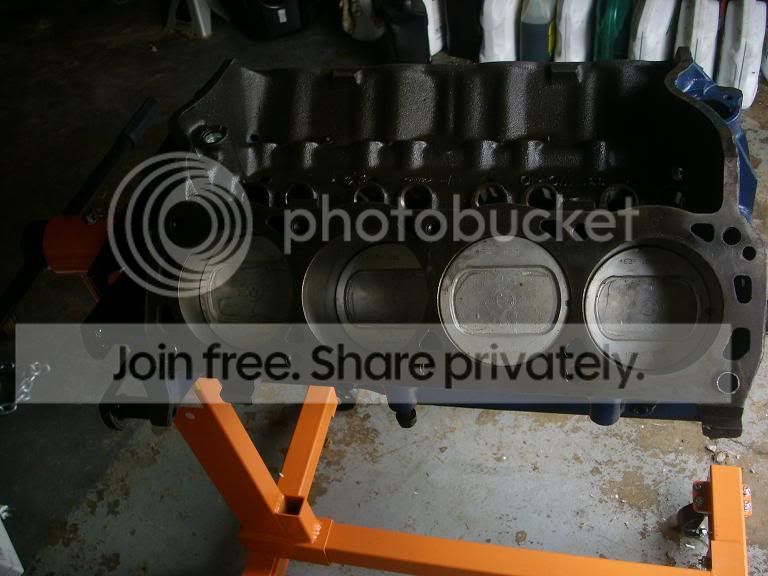

First thing I'd do id pull a couple main and Rod caps to plastigage the bearing clearance.
you could then just keep putting it together, But I agree pulling it apart and reassembling it would be a good idea. if for nothing else, to inspect and clean it. Is that surface rust in the Cylinders? If so then definately pop out the pistons and lightly hone the rust out. I've started junk yard motors like that and they run just fine, but this thing looks like it's gonna be a keeper.

Sounds like you know what you're doing, hahaha! I'd love to know you're cleaning procedure. I didn't know 98 Explorers had GT40 heads in them, new to me. Maybe I can go check out my local yard and see if I cant find some. I appreciate all your help and hopefully I can keep in touch with you and let you know how mine goes, been raining for a minute and haven't had a chance to do much more. The cylinder does have some surface rust, my buddy told me with some emery cloth I could more than likely get that surface rust out without damaging the walls.
I would also go with cleaning the cylinder bores with very fine emery and not take out the pistons. Then again, it might be better to just put some light oil on the cylinders and rotate the engine a few times to see if the rust will be wiped off.
Probably a lot of engines in vehicles that sit outside without running for a few months have cylinders that rusty but the owner never knows, he just starts the truck and away he drives with no harm done.
