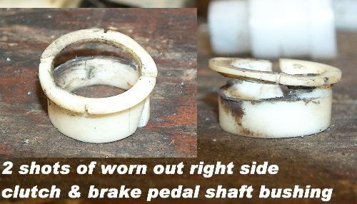

Hi all! I've replaced my worn pin and Clutch pushrod end with the infamous Hymen joint but I still have a little play remaining in the linkage "bar" that the clutch and brake pedals pivot on.
I've searched high and low for the plastic bushing that is between the main rod and the clutch pedal.
Note the pic below-I'm looking for the plastic bushing (as noted by "plastic bushing under here"-I found this pic on another forum..it's not my pic but accurately describes the specific bushing I'm looking for)
Here's another pic of that very bushing, pulled off the end of the shaft (again, I borrowed a pic from another forum):
Any insight out there for an OEM or Dorman (or other) p/n that I can search for?
By the way, here's the link to the Hymen joint set up I used from eBay.

The bushings are OEM, from Ford.
When I get to a computer with an optical drive I can look up the part number off my CD.
I haven't seen a hymen since 1980, at least!
That Heim joint looks like a great way to repair the pushrod bushing that I used an oillite bushing to replace.
Thanks for the link!
