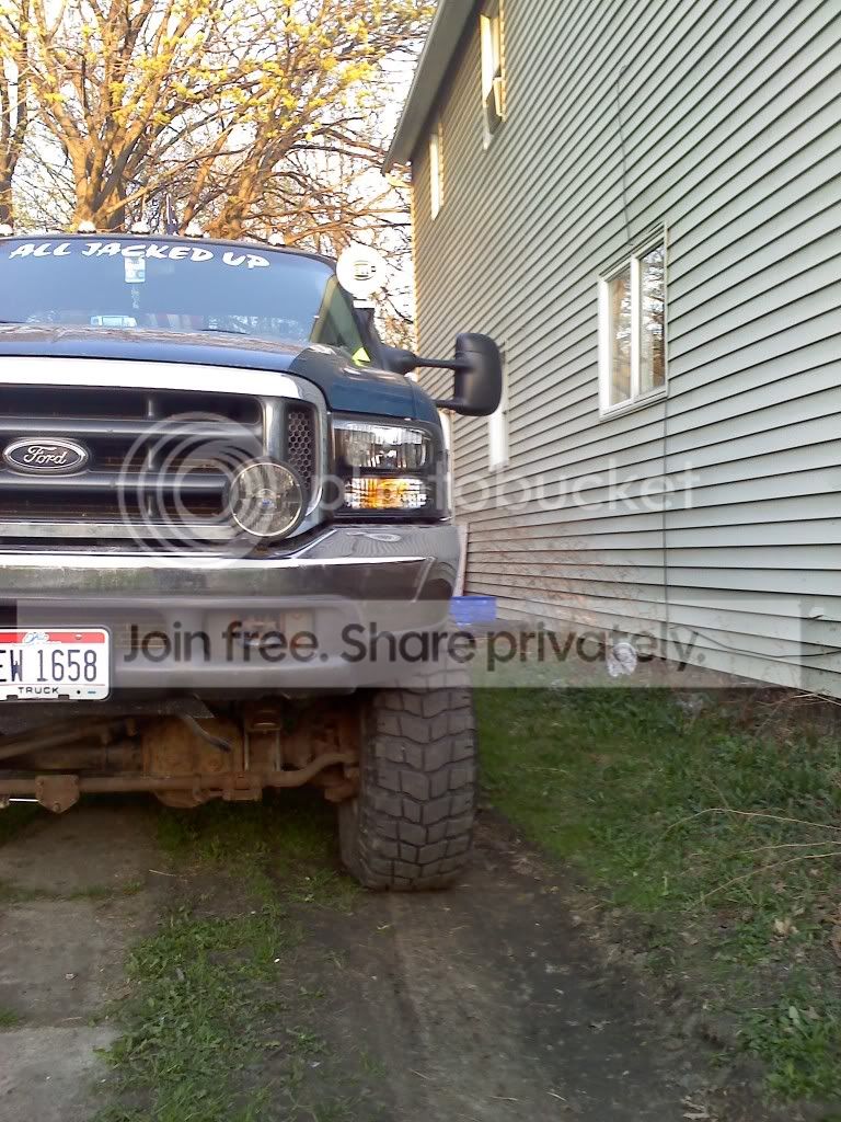

I have something very similar to those you posted. Mine are made by TYC and are actually pretty high quality. They have great light output and a pretty definitive line for the low beams. I have a lift, and even then, they still are bright on the road.
Like he said above, one you cut up your stock backing, there is no going back, but I'm not planning as my old lights were terrible.
