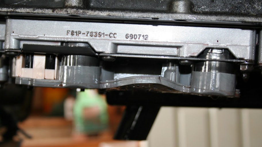

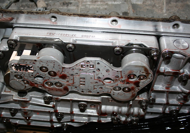

I bought this built up 4R100 recently for a V-10 project and when I took off the trans. pan I saw this on the servo pack. It looks like something dented the pan enough for it to make contact with the servo pack and push it up a little. It may have happened in transit, I don't know because I didn't pull it or transport it. How likely is it that this servo pack will actually work?

There is a good chance that it will have a problem. Wont know for sure unless you try it, if it was going into my own truck I would replace it.

For you the dealer is your best bet.
That looks like the part number printed on the side of the solenoid block F81P-76391-CC, I would let them confirm that plus there might be a updated block with a different number.
