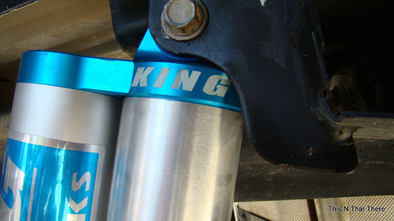

Problem with Rear Shock.
Solution?

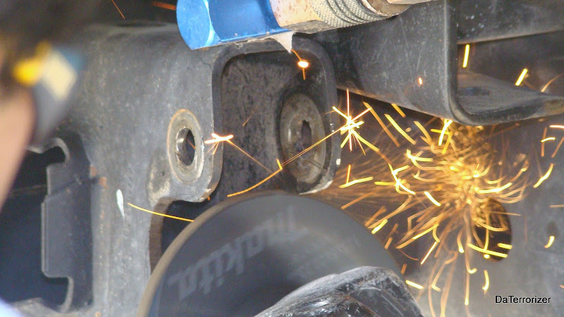

Grind some metal off.
Little damage done I'd say, but no problem, relax, take it easy, and don't worry about it.
