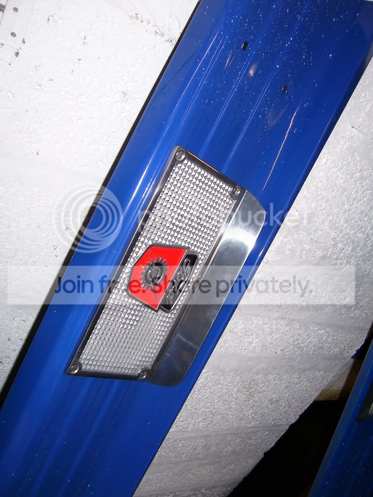

That's an interesting question - I never really thought of it before, and I have a set on my truck I put on.
I put mine as far out from the cab as I could get them and set the outside edge on top of the first high strip on the running board. I did this mainly to protect the running board from folks stepping up to get in the cab. And folks naturally tend to put their foot right on the running board edge.
Let em see if I can find a picture, that was a LONG time ago:
Name:  7. Step Plate Install.JPG
