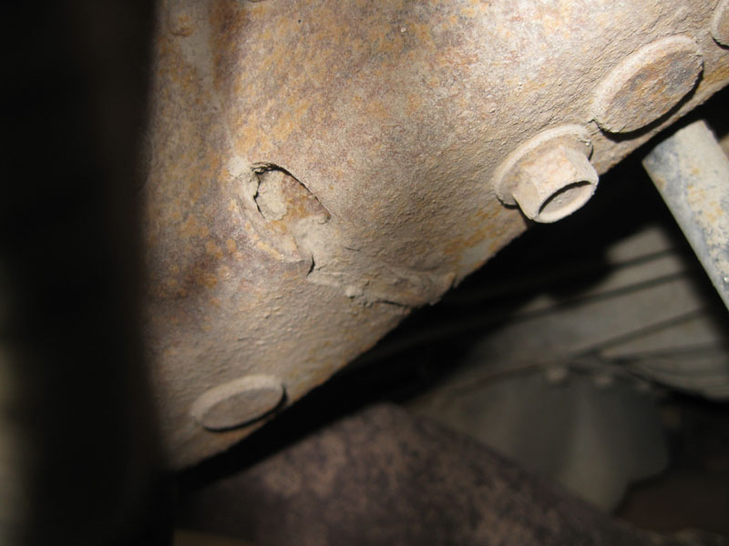

Thanks and reps for posting here in the Ex section -
Question -
In the pic below is that a crack in the frame/doubler adjacent to the lower double bolts securing the upper bushing?
(Lower right hand corner of the picture.)
Can't tell for sure from the picture - just wondering what I need to look for when inspecting the underbelly of the beast.

Originally Posted by 87mh
In the pic below is that a crack in the frame/doubler adjacent to the lower double bolts securing the upper bushing? (Lower right hand corner of the picture.)
No, its not a crack. I believe that's a relief cut in the frame that was required for bending it up. Looks like it was welded across the bottom. Here's a pic of that same location from the other angle...
