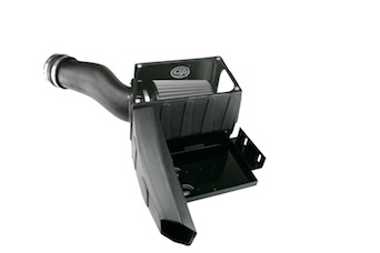

Here is an example of the S&B. It pulls from the finder liner and the snorkel from the "zoodad" hole.

they get more air then is needed from the grill (i used my stock snorkel as well) and the inner fender..i have too be carefull this time of year..the roads are constantly gray with salt..i need to wash my pro7 filter almost weekly it gets so nasty..i plug the hole in the fender and remove the snokel during winter times...that slows down the salt buid up and the truck keeps her power..the air is forced into the hood and grill across the motor then down under the truck to help with cooling..the trouble with these trucks is keeping all that air cold..AFE has solved some of that..looks like S&B are doing almost the same...but a little more restricted then the AFE

I got the same S-B setup, been great since I've had it, it sucks some air. This new design with the snorkle is nice plus the bottom of the box is hollowed out along with the side fenderwell area, the older S-B setups didn't have the snorkle.
