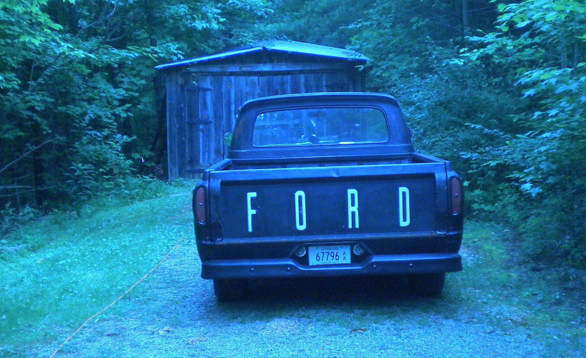

If I'm correct the bumper used on the Unibody is the same used on the styleside from 57 up to 63. It was turned upside down for use on the Unibody. At least that is the story I've been told.

Truck on Mecum site that I pointed to has the same rear bumper as Robert's other than chrome v paint - as far as I can tell. Here it is for a comparison.

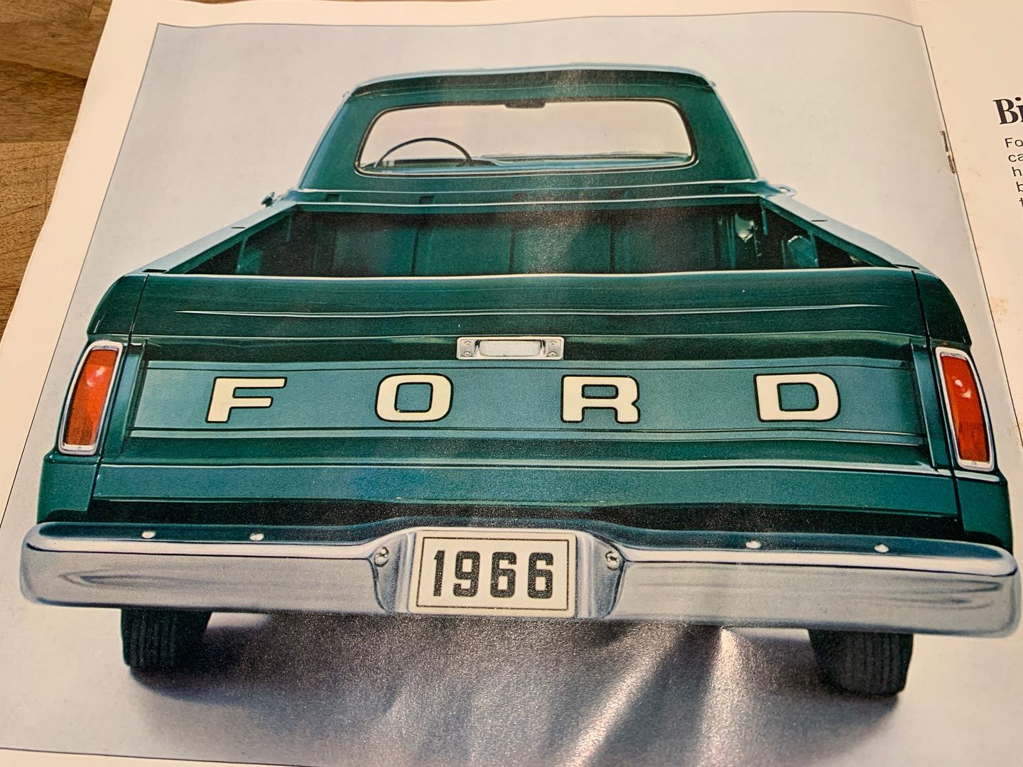

Here a picture of the 1966 rear bumper. You can see there are 4 carriage bolts on top. The one in the ad seems to have 6 bolts across the top. Probably a good chance 4 of them will line up with your brackets. If I say it will likely bolt up and it doesn't would you be mad at me?
It's definitely not identical so it's pretty much a guess if it will bolt right up or not using your brackets. I'd guess yes. Let me know if I'm wrong.....

It appears that some one drilled extra holes in the bumper in that ad. If you look at the bottom you will see the original square hole that is not being used. Not sure what they had that bumper on, so if you have your original bumper brackets, I would say yes it will bolt up, you will just have to plug the extra holes if that bothers you..

B7C-17906-B .. Styleside Chrome Contour Rear Bumper / Obsolete/Reproduced?
1957/63 F100/350 // 1961/63 F100/250 Uni // 1964/65 F100/250 4WD // 1965/66 F350 // 1966 F250 4WD
All of the above 1961/66 Stylesides (except the Uni's) used the 1957/60 Styleside beds.
C4TZ-17906-B .. Styleside Chrome Contour Rear Bumper / Reproduced (as are the brackets).
1964/66 F100/250 2WD // 1966 F100 4WD // 1967/72 F100/350 // 1973/77 F250 4WD (High Boys) // 1973/79 F350 Regular Cabs on the 140" wheelbase.
1973/79 used different brackets than 1964/72.
