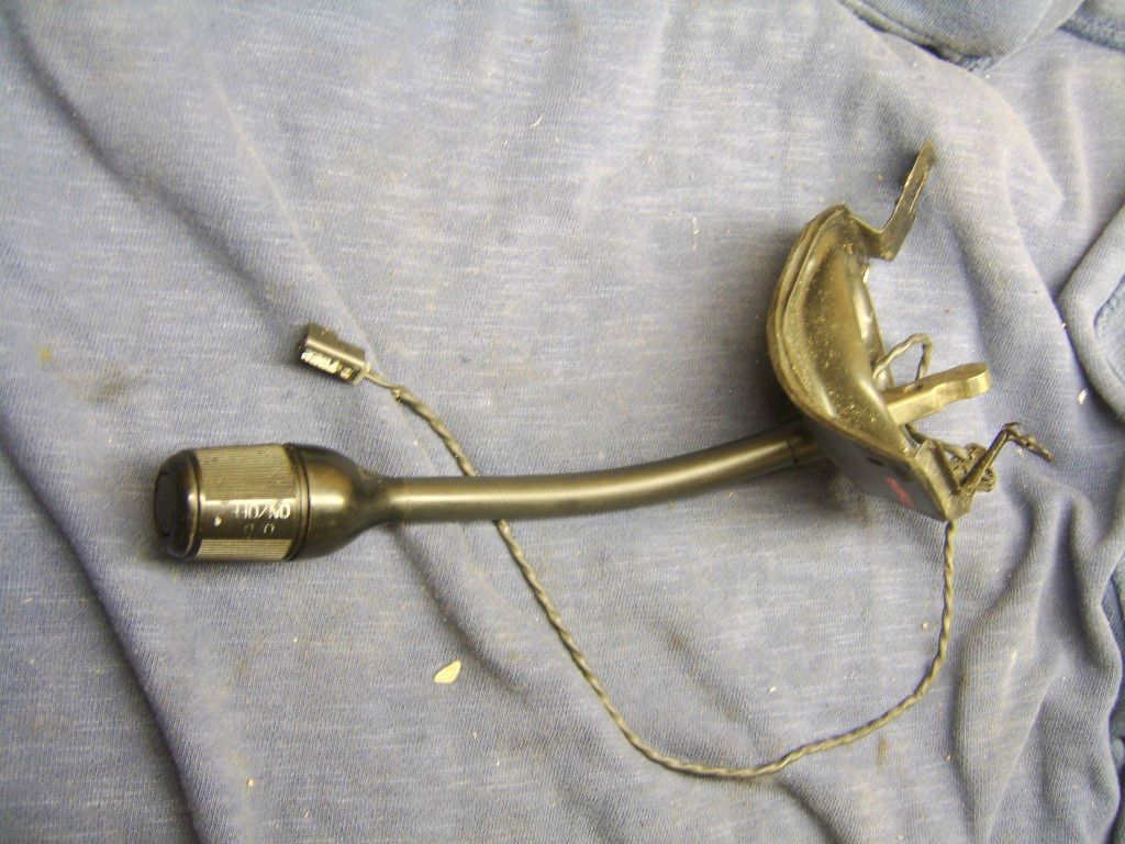

ok, i found the wires broke on overdrive in steering.. 2001 ford explorer sport..is there a special way to wire them? the wires are both grey under the black sheath....if i try to hook them up one way... i get a spark, then blow a fuse.. if i hook them up the other way i get no spark and dont blow a fuse, but do not see the overdrive light turn on on dash....please help?.....

These should just go to a switch. There shouldn't be any polarity involved. It sounds like you should check the wires to see if any of the four ends are shorted to ground.
I will try to pull the wiring diagram this evening to confirm the wires go all the way to a control module and are not intentionally tied to ground somewhere.

its a 2 wire .. it looks like this, this is not mine...but only 2 wires
