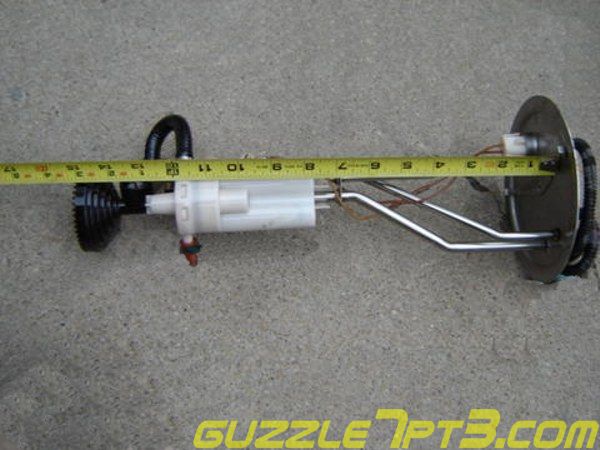

Chris has pictures.
The are located inside the mixing chamber on the end of the fuel pickup/gauge sender assembly, inside the fuel tank.
The fuel tank mods that we speak about is eliminating that part, putting a piece of straight pipe on it and then mounting an external spin on filter between the tank and the inlet of the fuel pump.
Doing that makes it easy to change the filter if you get a bad batch.
Simply spin on a new filter.

Sorry, been sleeping on the job I guess.
Yes the screens are inside the fuel tank. Drop the tank and remove the fuel pick up assembly
See the white plastic tube? That's the mixing chamber and there are 2 screens inside there.
Here's what they're supposed to look like
Here's what yours probably looks like
Doing the in-tank mods eliminates this problem from occurring. Dan's method solves this issue also, just in a different manner.
