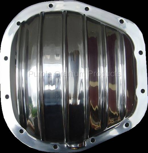

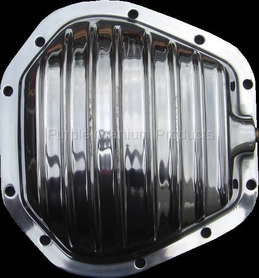

There are many aftermarket aluminum differential covers available. Here are some from Purple Cranium with extra capacity (see links below).
Dana 60 Front Cover:
Polished Aluminum Differential Cover - Dana 50/60/70 - Front Axle
Sterling 10.50 Rear Cover:
Polished Aluminum Differential Cover - Ford Sterling 10.25/10.50
