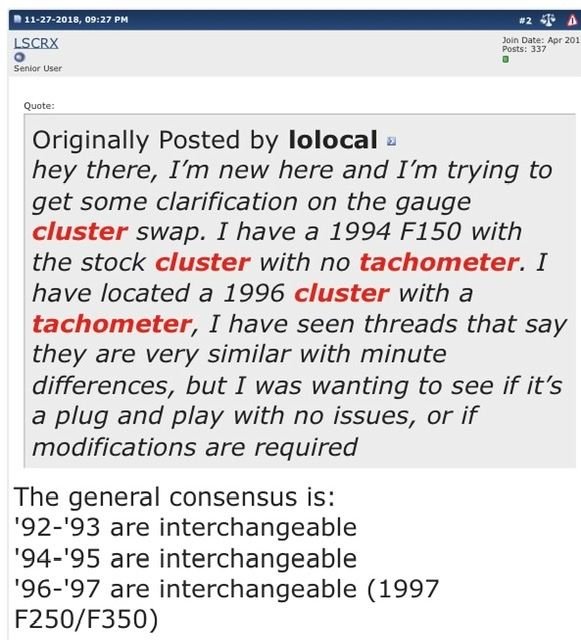

Im going to assume you used an OBD-I scanner to retrieve the codes or you bought an OBD-II that was compatible with the older system. If you didn’t erase the code(s) after replacing the sensor then they would still be in the stored in the computer. What is the code that you got for the wiring? Was it an active code or was it stored? Why would you put a different transmission in the truck and reuse the old converter? That is asking for trouble. They are different part numbers because a C6 doesn’t have a lockup converter which the e4od does. I do not know enough to say if it would work but I would not reuse the converter anyway.
You do realize in order to downgrade to a carburetor and 3 speed without overdrive you will also have to address the fuel system? Your ‘95 has a high pressure pump in each tank so you will have to get that ~50 psi down to 5 psi for the carburetor.

In your search for the possible cause of the erratic speedometer, did you come across which clusters are compatible? What did you use as a donor cluster There are differences in how they are wired and warning lamp configuration.

[QUOTE=My4Fordtrucks;20202248]I have reread his posts and am not seeing what you read. Would you direct me to the post number?
Its in post 45
