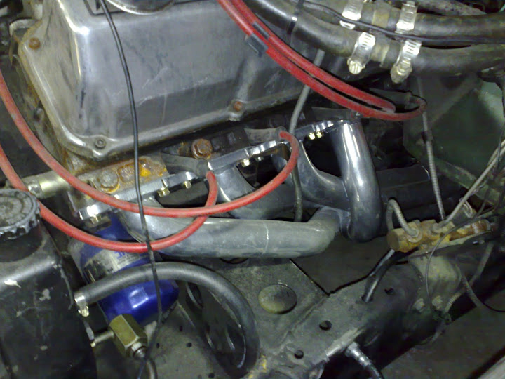

J1MMY,
When my Jag front went in, the chassis/crossmember was boxed up to replace the old engine mounts, with a few speed holes added. This is the best pic A can find.

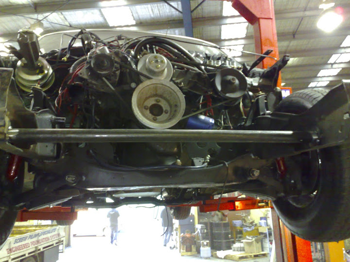

From: Australia
Oh, here's another one from above showing the passenger side mount (drivers side for the yanks...)
