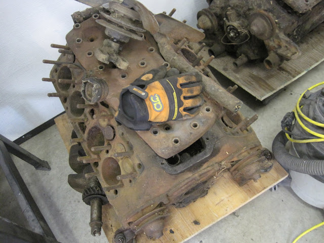

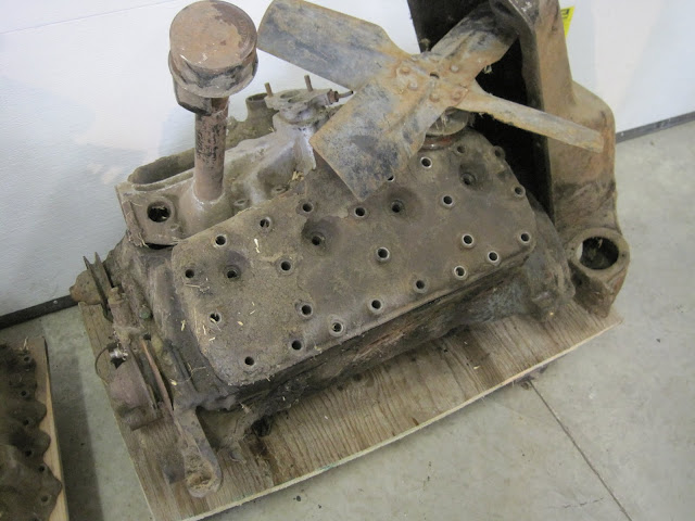

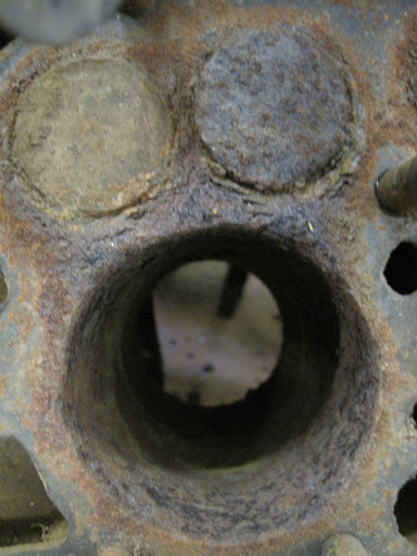

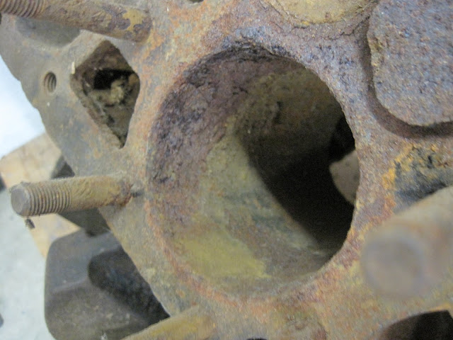

Got 2 blocks from another of Morris' contacts. We went out and pulled them from a dark shed, dragged them across a big ice puddle and man-handled them into the van. Once I got them home and cleaned up, I found one to be useless (heavy cyclinder rust), but the other may still be OK.
Guess I shoulda looked a little closer. Oh well - worth $50bucks as scrap (I've heard....!)

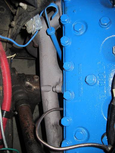

Detailed engine in the 46. Engine differences meant swapping fans and needing some different upper rad hoses....
Even had time to detail the manifolds and exhaust!
She will run SOON!!!!

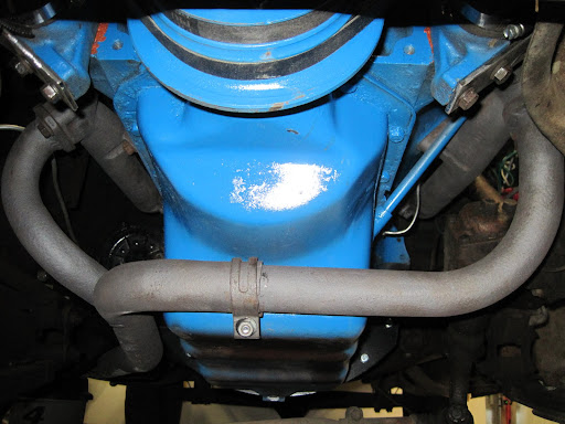

I'd appreciate a shot of the motor mounts you came up with, when you have a chance. They look simple.

I never saw an oil pan like that before
you have a nice set of triplets sitting there

its a 53-54 truck pan, i got one on my 53 effie
From what you see from below, they are just bent at about a 40deg angle and bolted to the original mount plate, with a piece of tire for insulation. I've since been driving it and they work just fine.

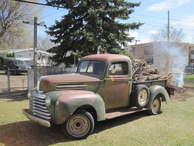

To get it running last weekend I had to re-lace the leads due to pulling the disty for paint, then had to pour nearly a gallon of fuel down the carb before she would suck from the tank....it finally fired and ran great, but was pulling water from a leak in the interior of thr rad. No apparent damage, so a can of Bar'sLeak was used. There's NO WAY I was pulling the rad so quick!!! After the BarsLeak it's perfect!! Next weekend - she pulls double duty: a trip to the dump and one to the Coop for some wood!
I guess this (sort of) concludes this thread....the truck runs, under alternate power. Once I get a 46 block that will work, I'll re-open it to show the rebuild.

The M1 is BACK to work!!
