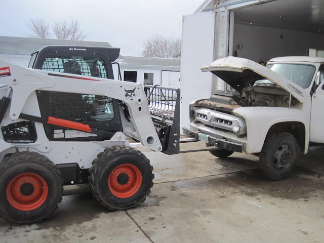

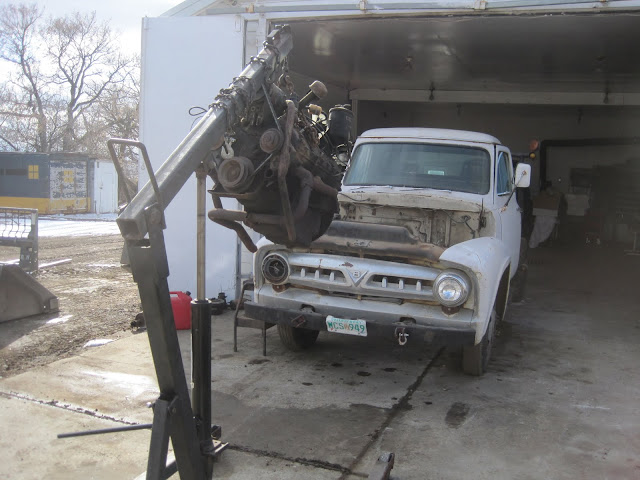

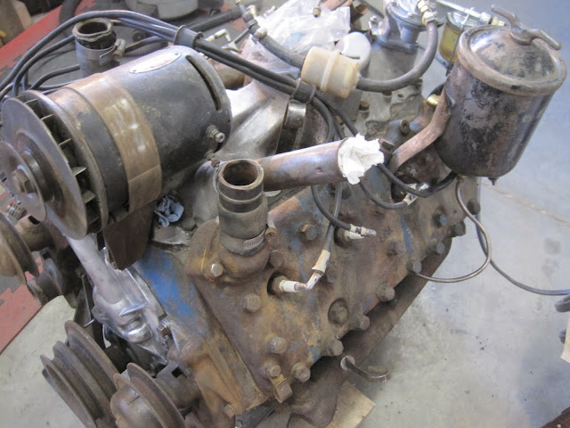

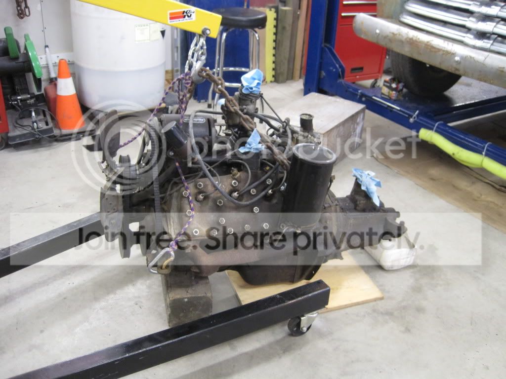

FINALLY - I at least found a "SPARE"! The Sask/Man moderator, FoMoCo (Morris) had a 51 truck that he wasn't doing much with, so was nice enough to sell me the running engine. We pulled it out on a Friday, I cleaned it up on a Saturday and put it in my shop on Sunday - ready for some paint. Need to figure how to attach it to my '46 3-speed case.... Anyone?
Brought it home in my Caravan....I know - MOPAR - yuk
I'm still trying to source a 46 Block from Keith Lee @ Jitney, put it's been slow going. This will give me more time to get that one back together. If there's one thing I hate, it's non-running vehicles in my yard!! Plus I use the Merc quite a bit all summer - for dump runs, pick-ups, fun rides with the boys...

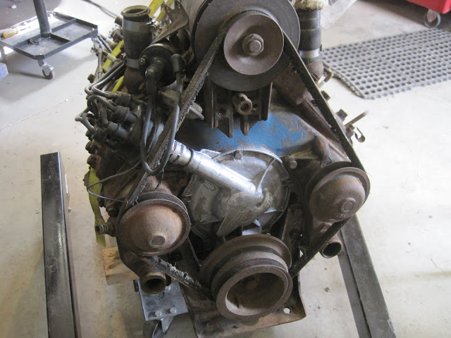

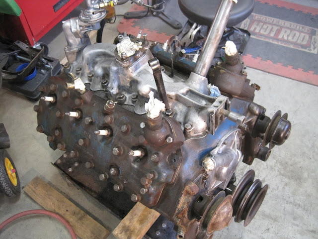

Here she is all cleaned up. There was a good 1/2 inch of crud on it, which I scraped, then washed with thinner, then Spray Nine, then pressure wasshed to get off...
Next up: Paint!
Old Mar 21, 2010 | 06:14 PM
HD74's Avatar
HD74
Joined: Nov 2008
Posts: 915
From: Gunbarrel, Co.
You need a bellhousing for that flathead, then your tranny should bolt right up, maybe, I'd have to see your tranny but you still need a bellhousing.

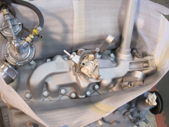

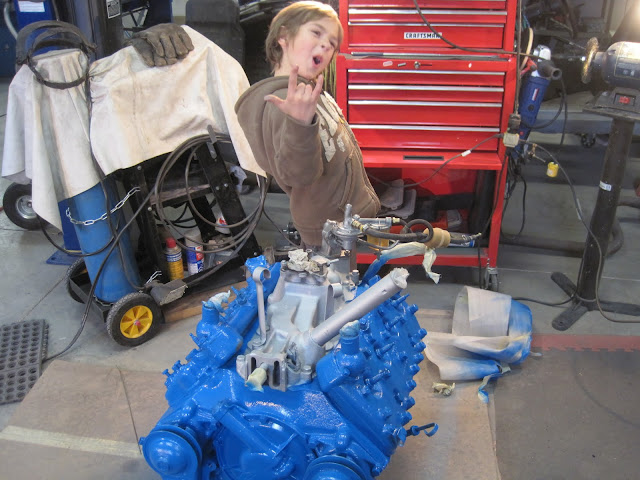

The big cleanup, continued:

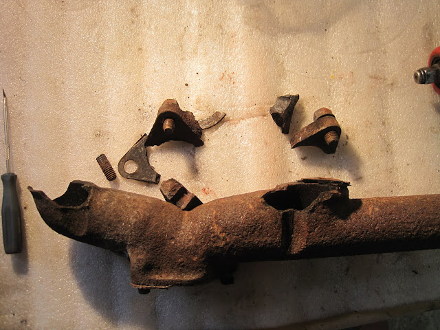

One manifold came off in pieces....not sure why???

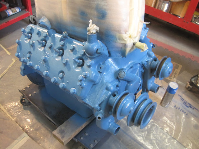

After much wiping with Pre-paint solvent and removal of several accessories...

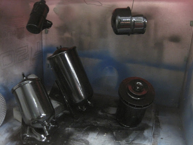

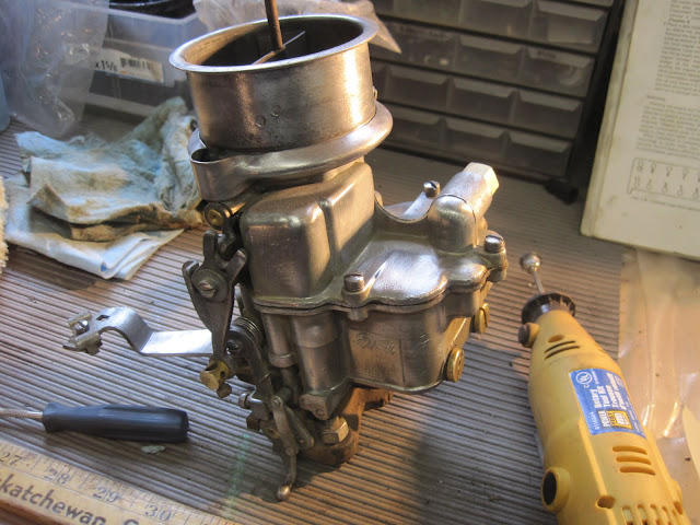

Buffed fuel regs and painted intake Alumi-blast (Eastwood)
Polished the carb:
Colton LOVES IT!!!!!!
After a couple days drying, I'll bolt all the parts back up. In the meantime I'm going to rebuild the 3 spd tranny. At the very least it'll get a set of bearings and gaskets, but I'll also check everything else and repalce as necessary.

Looking sharp painted all up in the blue! Bummer about the manifold, will the one from the original engine work?

Yup - manifolds are the same. As are most of the externals. I'll just be happy to get it running again!!
