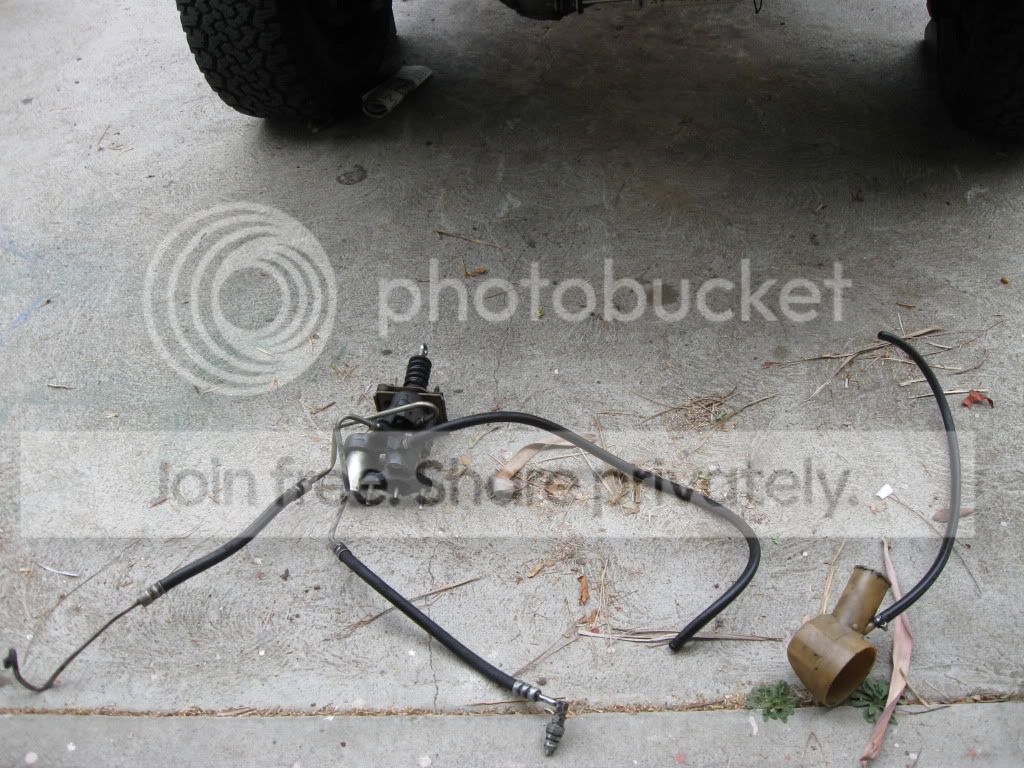

You will need five distinct parts: The pressure hose going from the power steering pump to the hydroboost unit, the pressure hose going from the hydroboost unit to the steering box, The return hose from the hydroboost unit, the hydroboost specific reservoir, and the hydroboost unit itself. I got my parts off a late 80's, early 90's Super Duty. Now would also be a good time to get an o-ring seal kit for the power steering pump.

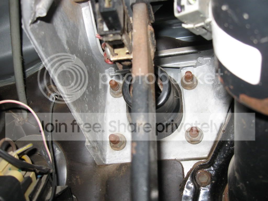

Now we move to the inside. Take off the cotter pin that retains the booster shaft to the pedat. Slide off the brake light switch and the bushings. Now you undo the 4 bolts that hold the booster to the firewall. Pull out the booster, and the old one is out!
Now we can do our install.
The new one bolts right in place of the old booster. The four bolts line up. Tighten those down from inside the truck. Next, mount the master cylinder to the booster unit, and tighten the nuts.
Now, lets move to the inside. I ran into a MINOR problem. The brake light switch did not line up. I put on the hydroboost shaft onto the pedal, but could not get the switch on. My solution - turn the switch 180 degrees. Now the U shaped part of the switch is on the outside instead of the inside. Put the bushings in, and the cotter pin and you are done with that part. You might need to adjust the cruise control switch, but that might vary.
Now, onto the last part - the power steering pump and reservoir.
Start by draining the old reservoir. There is no clean or pretty way to do this. Next, disconnect the original return line from the bottom. Disconnect the pressure line from the side. Remove the fitting from the side of the reservoir. Now, wiggle off the old reservoir. There is a large o-ring on the pump that seals to the reservoir. Now would be a good time to replace it. Of course, I did not. Lube up the o-ring and the inside of the reservoir with power steering fluid, and slide the reservoir onto the pump. Put the fitting you had taken off of the pump back on. It uses o-rings too. Now would be a good time to replace them. I did not, and had a little leakage.
Next, connect the lower return line to the reservoir. Connect the upper return line from the hydroboost unit to the reservoir. Now connect the pressure line from the power steering pump to the hydroboost unit. Last, remove the pressure line from the steering box. Connect the new pressure line from the hydroboost unit to the steering box. A lot of these lines use an o-ring on one end. make sure it is in good shape and lube it up before putting it in.
Now, fill the pump and bleed it.
You are now ready to go!

Good write-up! I have two things to add tho:
1) if your truck has an aluminum master cylinder with a plastic reservoir, its bolt holeswill not line up with the studs on the hydroboost - you will need to take a small die-grinder to them and elongate them a bit towards the outside, we're talking about 1/16" each so nothing gets weakened by this procedure.
2) on certain trucks (IIRC the '92-'96) the hydrobost will bolt up to the firewall, but the linkage rod that connects it to the pedal will sit a very steep angle, which may actually bind the linkage. Solution to this would be grab the hydroboost-specific brake pedal, or simply grind the pin off your factory pedal and weld it a bit higher on the pedal.
