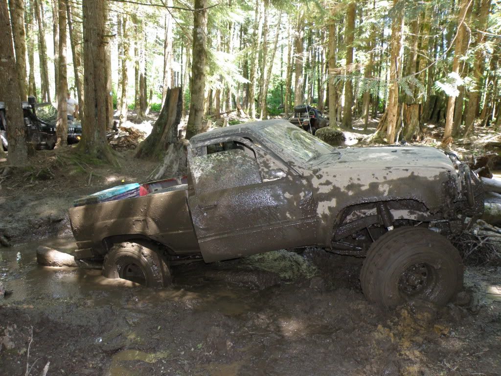

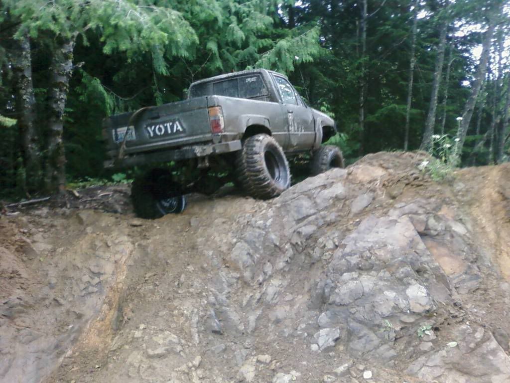

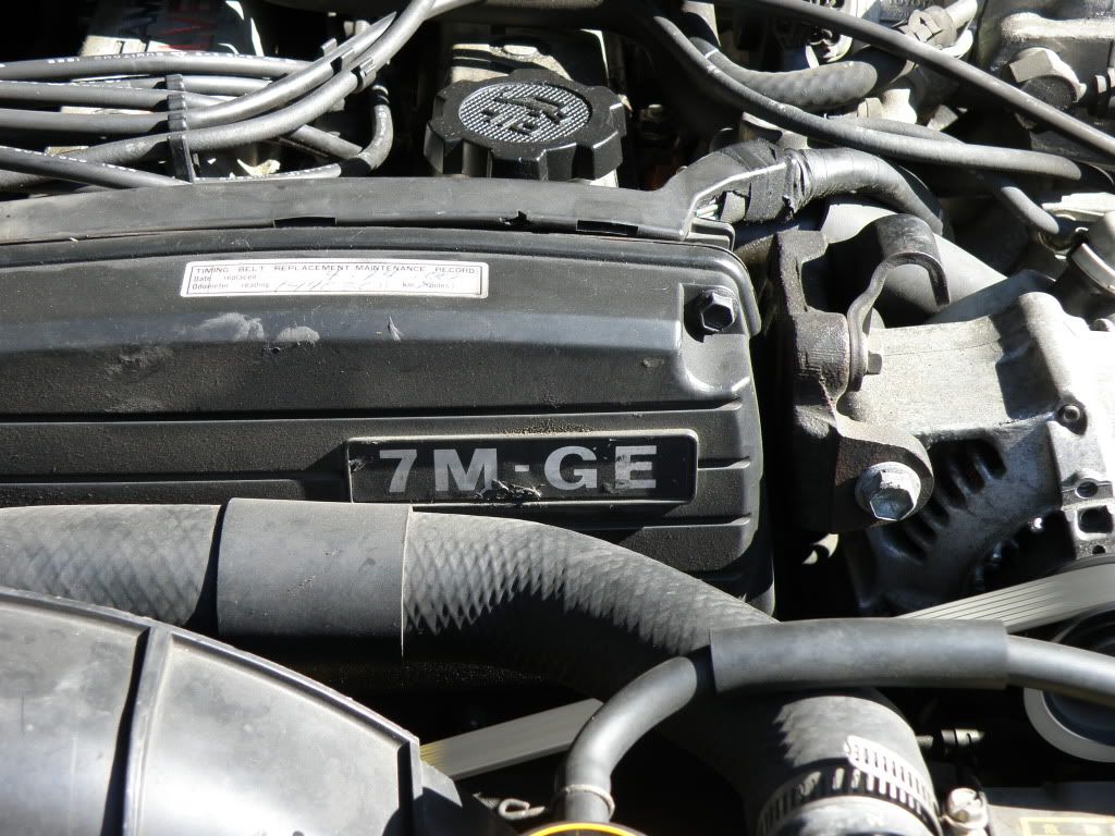

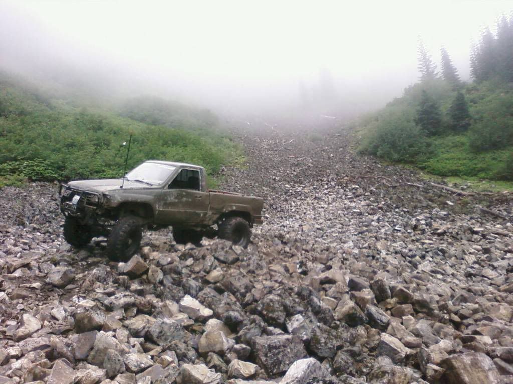

It's got a 22r carbureted 4 banger for now. 2.4 liter gutless little thing but tough as nails, you beat the hell out of them they just keep chuggin. Real simple motors too, you can swap a head gasket in 5 hours
Going in it's place in the next week or two is this 3.0 inline six
Naturally aspirated from a 3rd gen Supra. Should double my hp and nearly double my torque for 180 ft lbs and 180 hp at the crank.
I know its still not much but i dont need much to get around in a 5k lb compact truck. Just wanna turn my 40's
Still running factory 4.10 ring and pinions which is way to tall, i need 5.29 for these tires but 4 D's are comin soon so i'll probably go 5.71
Got a G52 trans and an RF1A tcase (gear driven, not chain) so i'll probably be throwing 4.70's in there if i dont dual case it. Twin sticks soon too
Not sure about the gear ratios in the trans and tcase

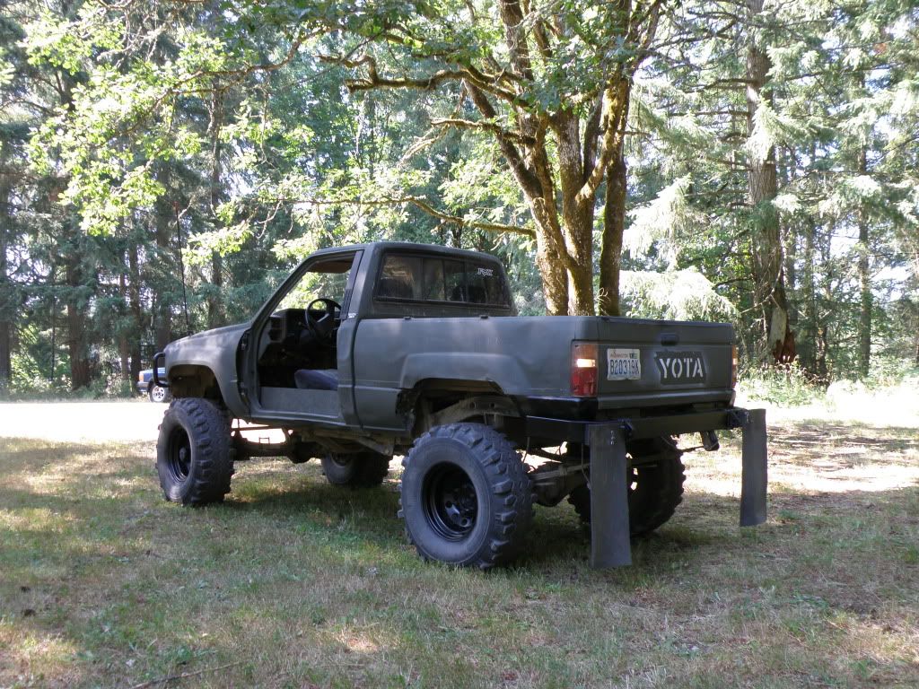

Few pics back on 33's
(yes i need the mudflaps by law)
Heres the lineup
