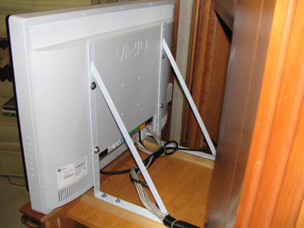

I used a swing arm VESA mount in the bedroom of my Champagne Edition HitchHiker. If you go this route, make sure that the wall of the cabinet you mount it on will withstand the weight. I put a sheet of 3.4 inch plywood up against the inside wall of the cabinet and then mounted the swing arm to that. The television is a 26 inch Vizio that replaced an older tube type 19" Magnavox.
In the living room, I used a couple of large L brackets from Lowe's. I mounted them on the sliding tray that held the big 27" tube type Magnavox. I replaced it with a 32" Vizio and still get the sliding mount so the television can pull out and swivel. I put a shelf in the back of the television to store CD's and DVD's.

Greg; those installations are great. My living room has a large cabinet that a 32" will fit into. I have a slide that move within 3'' of the cabinet face. The use of the swivel is a good idea. The rear space can be accessed for storage. The swing arm in the bedroom sounds good to me. How do you hold the units in place during travel? Do you have a way to take the wieght off the arm during travel? Thanks for the pics.

Living Room: The shelf that the television sits on came from the factory with a locking latch built into it. There's a **** under the television that pulls out about 1/4 inch to release the shelf to allow it to slide out and swivel as shown in the pictures. When the shelf is in, the television is flush against the cabinet panelling. The television sits outside the original opening, so it is held tight against the pannelling with an overlap of about 1 inch on each side and the top. It doesn't move since the L brackets are a solid mount.
