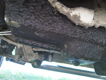

Posts: 97
How do I know if I have a low or deep oilpan? Can you tell by looking at it? Maybe some one can inform me. Maybe it has a small leak to boot lol =(
<BR><BR>
That's your oil pan, the shallow/deep pan is the trans pan. Looking at the oil pan, I think you have some serious cleaning to do so you can figure out where all that crud came from!

x2 on the cleaning...
