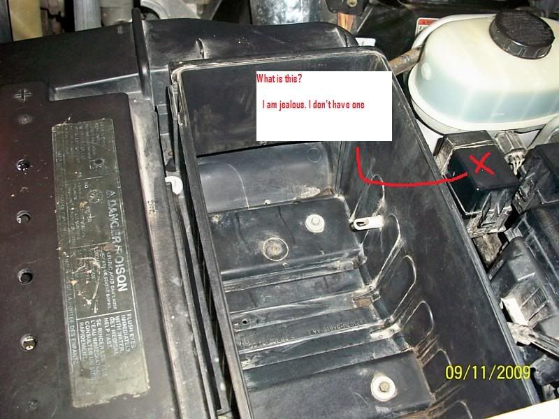

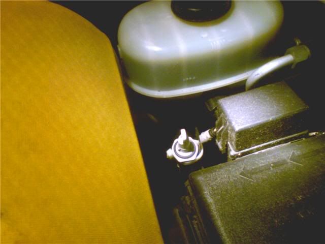

I was going to come back to mine someday and stick it in side but i haven't had time. I stuck mine here for now.
Ok.. I got same year. What is this little box. Fuses/relays for 4x4?

Not sure what this box is for. Will look tomorrow and will let you know.

I have that box too. It makes the 6637 fit a bit tight. Just zip tie your IAT sensor to something solid behind the filter.

Tied it off to the little black box. No problem. 6637 mod completed. Thanks for the help.

I think that box is where the ESOF relays are and that would explain why Dan ain't got one.

The vac pump and the solonoid for the ESOF are on the passenger side of the truck on an 02.What model is the picture in?
Went back and looked at sig.....01

Interested to know what the box is as well with the other ESOF stuff on the other side?

The Vacuum pump and solonoid is on the passenger side of all our 4 wheel drive trucks, but on the 01's and back, the relays were under the hood on the drives side. Two relays under each little box. One box, I think the closest to the air box, it the ESOF and the other is trailer two relays. Everything went in the cab, under the dash in 02.

Handy to know also it all 4 relays are the same. Should you ever be in a bind and you 4x4 goes out, you can switch out the trailer tow to get you going, if that's the problem, and replace the bad on later. And you are welcome.
