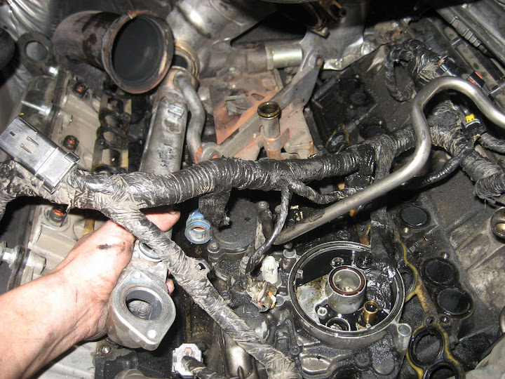

Old Aug 22, 2009 | 09:32 AM
D8chumley's Avatar
D8chumley
Resident smarta$$
Joined: Aug 2006
Posts: 4,929
Likes: 9
From: Oaks,PA
Is this the one you mean?
Old Aug 22, 2009 | 10:07 AM
D8chumley's Avatar
D8chumley
Resident smarta$$
Joined: Aug 2006
Posts: 4,929
Likes: 9
From: Oaks,PA
A better pic of it
