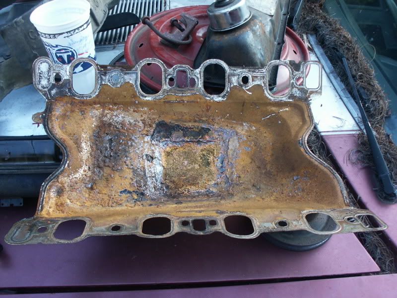

Another oddity. For some reason the valley pan gasket has holes rusted through it. Never seen that before. Don't know if it relates, just thought it was weird.

yeah, i've found rust pinholes in the valleypan before, that's why i prefer to not use them any more, or at least put something on them to protect from rust.
