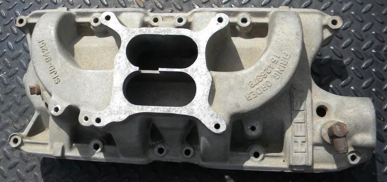

good point, didn't shelby prove that back with the K code 289? ford 's K used a cast iron intake with a autolight, 271 hp, shelby used a self branded dual plane with a holly, 306 hp
Shelby also mounted that carb on a high rise aluminum dual plane intake. Hardly the same as the Ford iron intake. Ford came out with the Shelby version in 69 as their C9OX intake. and they used Tri-Y headers. So it wasn't all the carb change.

shelby did do a lot,came up with a lot of great working items, yet this is the intake i'm referring to that is on the 66 306 hp k code that i have, along with the 650 single feed holly .

baddad457 is this the highrise you spoke about?
