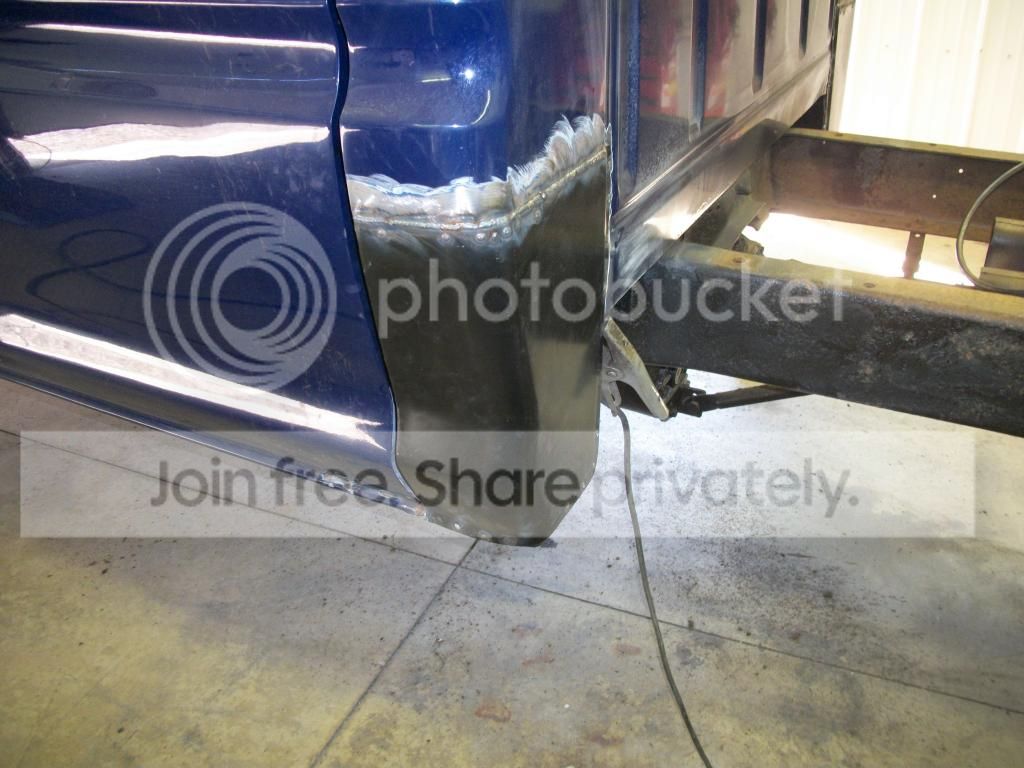

Before I had a welder and the skills to do things right, I used this product: No Weld Panel Adhesive Replacement
Small tubes, but goes a long way and uses a regular caulking gun. It has held since 2008.
