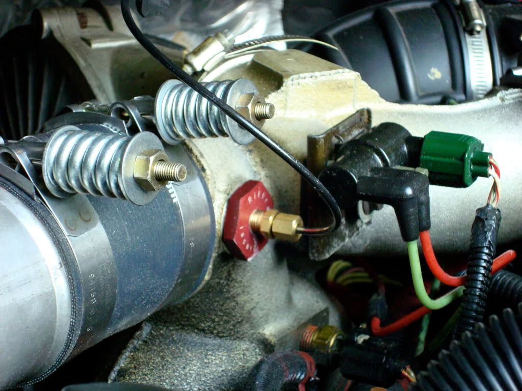

Took it for a spin this morning and the gauges works. I do have to 'get on it' for the needle to really climb and it tops out at 15lbs. Could that be a small leak in the boost gauge tube or more like a leak in the IC system? I thought I checked all the clamps when I first bought it.

15 is low, should top higher than that. Could be a leak it the line or in the boots.

I just want to know; Where did you get the fitting?
I got the AIH plug from clay, but I have yet to find the 1/8npt to compression fitting anywhere locally.

Mine came in the tee that came with my gauge kit. I just unscrewed it from the tee, put a little teflon tape on it, and screwed it into the AIH plug. Here's a pic of the tee (ignore the HPX text):
Here's what it looks like screwed into the AIH delete plug with a new line between the manifold & my OBA:

I used the one that came with the gauge but Carquest has them. Since I drilled out a Dodge drain plug that had a pretty deep 3/8" square hole for a wrench, the 1/8" male wasn't long enough. I went to Carquest and bought a male/male 1/8" npt and then used a 1/8" female to ferrell fitting. Not before cutting off some length of the drain plug. I didn't see the point of installing a super long plug, that's the whole point of the AIH delete anyway, right? So I cut to equal the AIH threads.
Threads cut down.
Original length.

I was only getting 15lbs on stock. 20 lbs on my Race mode chip. Made a boost leak detector and found out my I/C boots are leaking also the up pipes behind the turbo are leaking big time. So check both. I bet your up-pipes are black.
See the black soot coming from the flange. the other side is worse.
