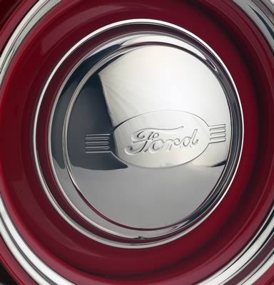

I like the Cragers too. I'll probably move them over to a '51 Ford that I have. I have something like this in mind for this truck:

  #30
bobbytnm's Avatar
bobbytnm
Roast em' if you got 'em
Joined: Mar 2005
Posts: 21,989
Likes: 9,853
From: Rio Rancho, NM
Very nice!
Those would look great on your truck!
