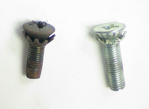

i know its been on here before. but were can i buy the screws for the door hinges for a 49?

I found allen screws at a hardware store. Don't bother with the big box home centers, these screws are unusual. I found an old tru value hardware store, the kind where the old man greets you at the door and offers to help, and they had the correct thread in several lengths. They don't have the star washer, but I lock tite everything anyway.

The thread is 5/16- fine thread.

I personally wouldn't use the Allen head bolts in my door hinges, I'm not trying to sound snobby but I don't think I'd like the look. The door hinges are a relatively noticeable area and I think the Allen heads would look too modern. If you're doing a modified truck then I probably doesn't matter. I did use Allen head bolts to bolt my panel body to the frame though. I did this because Ford in their infamous wisdom use those stupid square hole bolts, just like the ones used in the pickup boxes, and are pain to work with because you have to grind a 3/8" extension down to fit. I was able to find Allen head bolts that had the same head as the stock bolts and I doubt anyone will notice.
