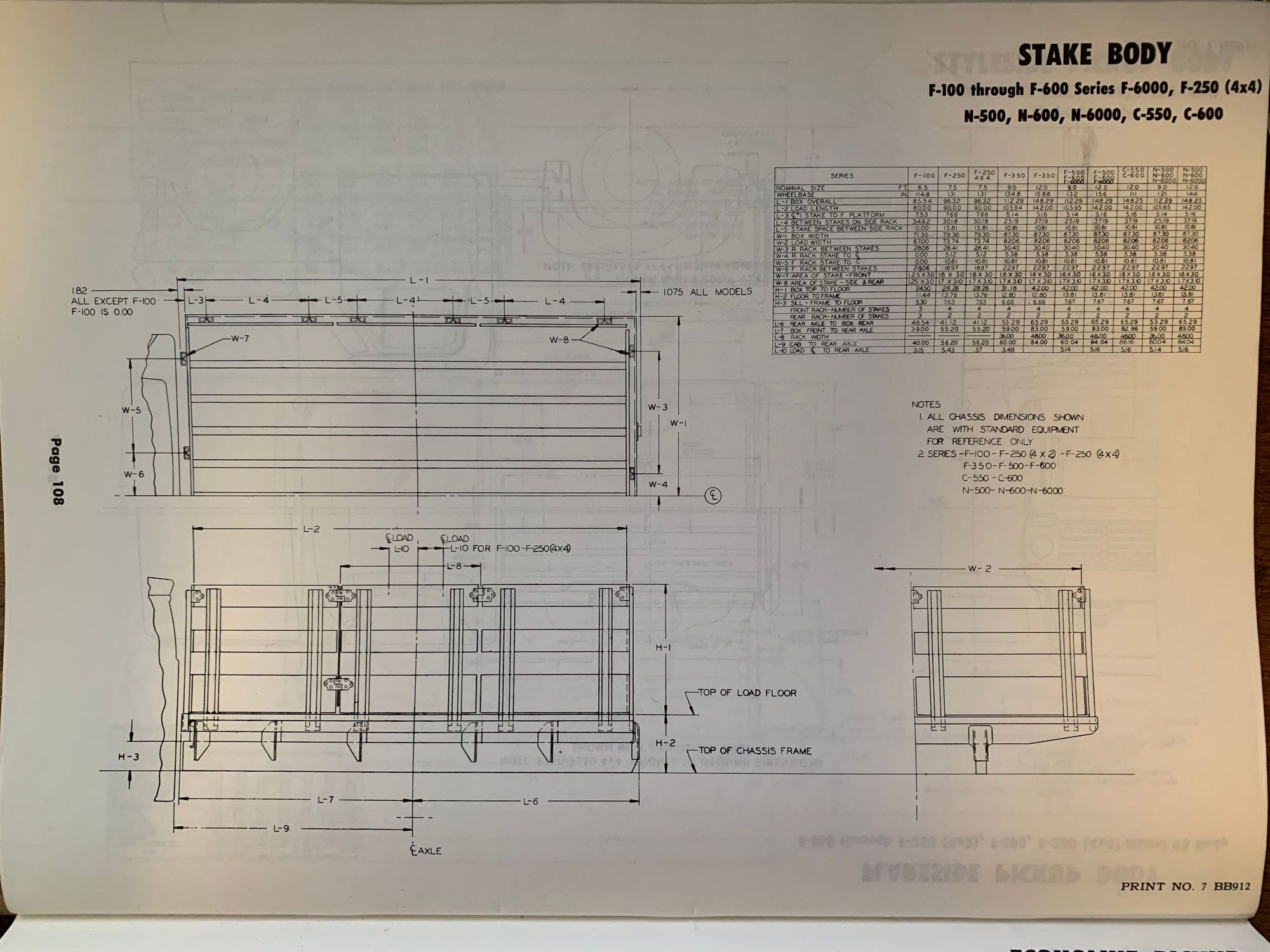

From '67 Body Builders layout book
I have this but it doesn't specify the placement or number of the internal cross members of the bed. But I can tell I need to add about 1' between the wide stake pockets.
