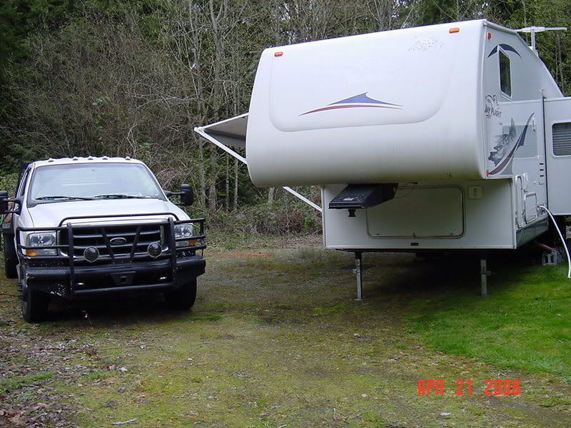

Here's the 'fluted' ('99-'02) lenses with 'clear' turn signals from Recon (junk). BTW, the aircraft landing lites on this bumper are unfreaking believable for light output - wish they fit on my new bumper.
Here's the 'clear lens' ('03-'04) and turns from same year. (only pic I could find! - this was camp in Seattle last summer...)
And finally, the '05-'07 ($155/pr - "Eagle Eye's") and '07 grill w/new bumper. Looks GREAT, but miss the extra lite. I ordered some Hella bulbs, we'll see if that helps...
