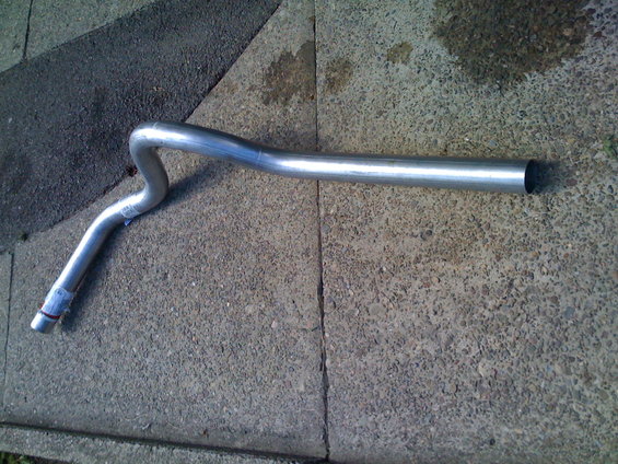

It's a single exhaust that looks factory. No idea on size but too small and not near loud enough! I had my hands on an '85 460/4sp that I had the local exhaust shop put a single 3" with Flowmasters on and it was a great exhaust. Sounded awesome. I'll go with whatever that shop thinks would be "appropriate."

3" pipes and mandrel bent exhaust: Maremont part# M30001 for about $40:
