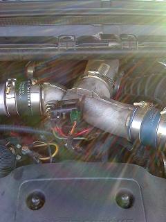

Whitey Ford's Avatar
Whitey Ford
FTE-Spread The Knowledge
Joined: Feb 2008
Posts: 2,290
Likes: 250
Name:  7.3 PowerStroke.jpg
Brandon:
1) So I remove blue and black boots from manifold.
2) Then take off top two sensor's with 7/16 nuts on them.
3) Unplug bottom sensor.
4) Remove clamp from manifold to turbo
5) Loosen orange boot clamps, top and bottom.
6) Wiggle manifold out.
Everything is in the picture right? Well maybe not orange boots.
Thank you very much.
Mike

Originally Posted by Whitey Ford
Attachment 13621
Brandon:
Mike
Actually Mike the 7/16 is to remove the clamps holding the black and blue boots on.
You do not have to remove the sensor plate, the red and green tubes will just unplug from the fittings.

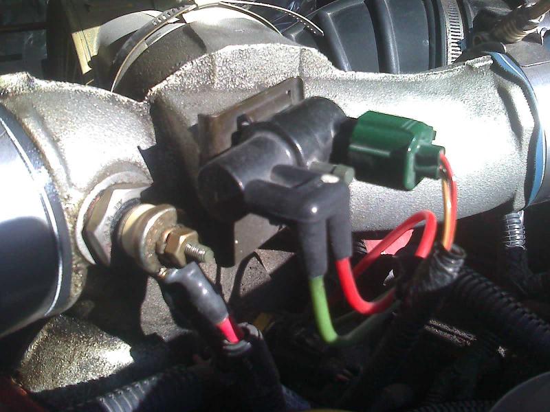

Brandon...Does the red and green tube in the middle of the picture below, pull out of the black rubber 90? I see how all the other disconnect. Probably change black and blue boots. They are very soft. I really appreciate the help.
