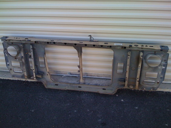

Finally got back to the yard today for another radiator support. I found a nice rust free one from a southern truck.
All went well UNTIL I had to try and get the two lower support bolts out that go through the frame. I knew it was going to be tough, but it was a real PITA because the nuts/bolts were rusted solid.
It's a good thing I too a hammer and chisel with me because that was the only way they were coming off. It took quite a bit of persuasion to get them out, but persistence paid off. I was not about the leave without it after taking every other bolt out.
The plan is to spray paint it black and get everything installed this weekend if it doesn't rain.

When I did my clip swap I couldn't get those bolts out either. I got the nuts off, but left the bolts there since I needed them anyway.

It's a lot different when you are working at home with torches, air tools, sawzall and power. You can take just about anything apart if you have access to this stuff.
Getting old rusted out radiator support bolts out in the junkyard is a whole other story when you can't use any of the above.
I always take a sharp chisel and hammer just in case. I had to split the nuts off from the top and was able to slide the support out over the studs.
When I get some extra coin, a battery operated sawzall is on my list. It would make stuff like this much easier if you can get in there to cut it off.
The chisel and hammer almost always works, but it's a he'll of a workout and can be very frustrating. I was determined to get it out because it was so nice and the price was right.
$24 out the gate for an OEM support.
