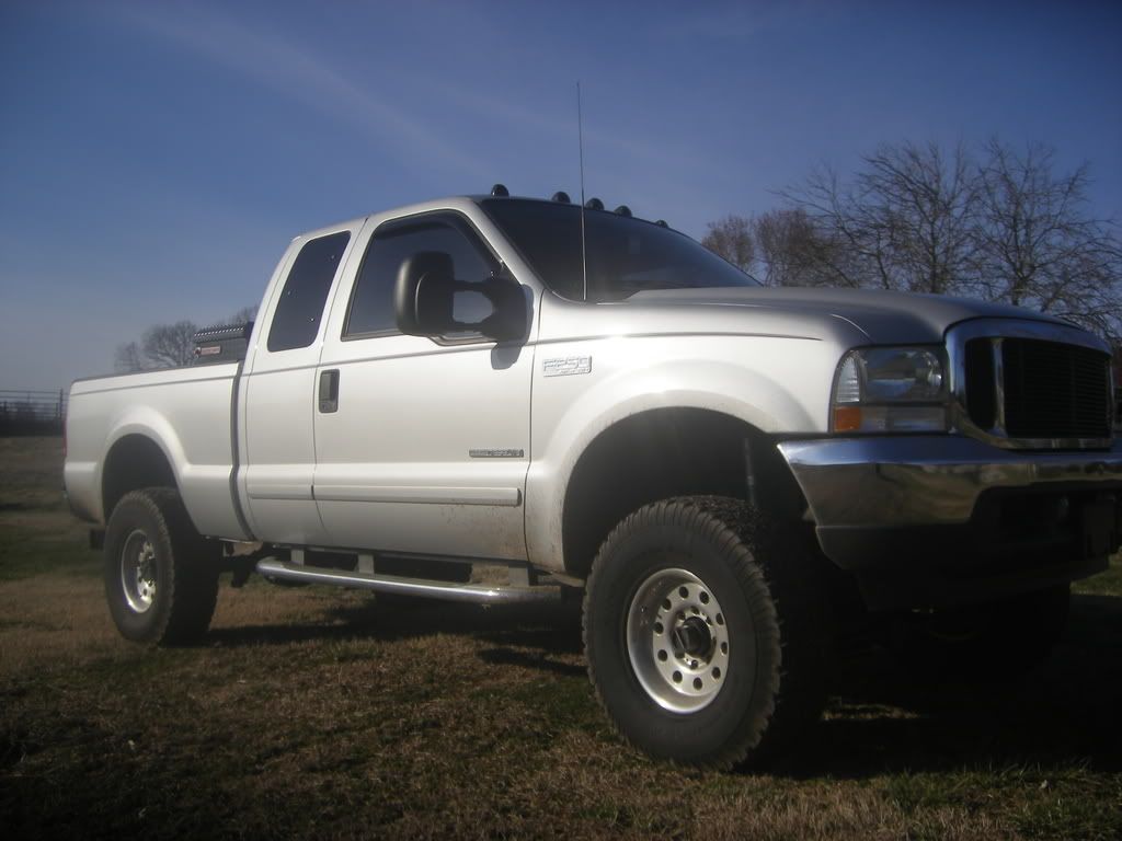

I just did mine last week, Bought them from recon, the kit for trucks that did not have them from the factory, it comes with the wiring harness for the lights and a wire to tap into your parking lights. I did mine in about an hr and a half. I wired them into the back of the headlight switch. Remember, measure twice drill once.

do you have any pics yet?
Old Feb 23, 2009 | 06:45 PM
Ziggy.'s Avatar
Ziggy.
Joined: Feb 2009
Posts: 1,325
From: Blaine, TN
yea, give me a few min and i'll have them up
Old Feb 23, 2009 | 07:19 PM
Ziggy.'s Avatar
Ziggy.
Joined: Feb 2009
Posts: 1,325
From: Blaine, TN
these are the only ones I could find, and of course it had to be the ones where the trucks a lil dirty, but its all good
Old Feb 23, 2009 | 07:34 PM
patrickke's Avatar
patrickke
Joined: Nov 2008
Posts: 1,637
From: Lexington,Ky / Owensboro
lookz good maybe next mod after new exhaust
