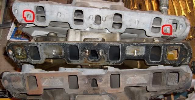

In this picture, the stock intake is on the bottom, the Edelbrock Performer is in the middle, and the Offy Dual port (which is NOW bolted on the van) is sitting on top. I have circled in red the extra bolt holes in the Offy intake. It is the same on the other side.
The factory intake is water cooled, as are the Eddy and the Offy. The heads have coolant passages front and rear, but the factory intake, and the Eddy and the Offy, only have a cooling passage at the front of the intake. For some reason the gaskets have both front and rear coolant passages, even though only the front is used.
The factory intake has a square coolant passage hole, but the Eddy and Offy both have inverted "L" shaped holes.
I believe that I can tap and plug all four extra bolt holes. The existing intake gasket keeps the coolant flowing where it should, and the bolt holes aren't in the head. Therefore, the only extra holes are in the intake, so I should be able to just tap threads into the aluminum intake and find the right size pipe plugs to fill the holes.

I think you got the most efficient solution to your problem, make sure to use some sealant on whatever you use to plug the holes.

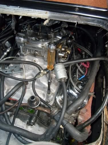

This is what I started with:

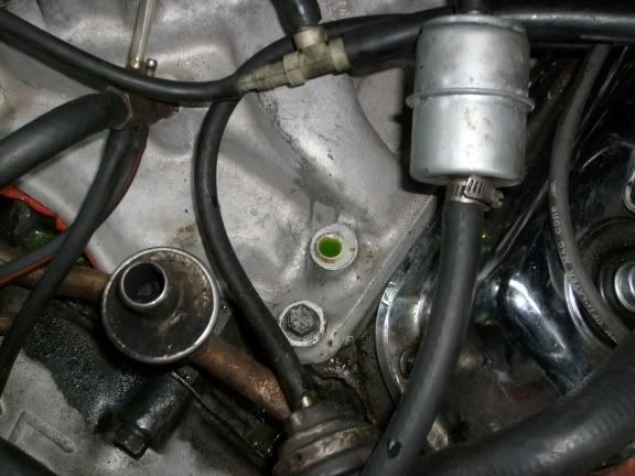

There were four of these holes, one at each corner of theintake. This was the easiest one to photograph.
Here is my high-tech, super accurate machining tool:
Yes, a 1/4 drive ratchet and handle attached to a 1/4 inch 8 point socket which fit over my Napa tap. All the stuff on top of the motor made it hard to fit the regular tap handle in there, so I had to improvise. If you are going to be doing any machining, I HIGHLY recommend you use cutting oil. Last night i tried tapping out this hole with just the tap and the regular handle, and it ws so hard to turn that the tap handle stripped. So this morning I made a pilgrimmage to Tacoma Screw (an awesome store: Tacoma Screw Products, Inc. :: Home ) and got the 8 point socket and a tap handle. While there, I picked up a bottle of aluminum cutting oil. MAN, what a difference! I won't say it made it as easy as cutting through butter, but just about. It took me all of about seven minutes to tap all four holes.

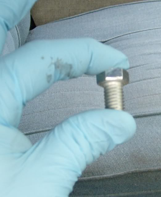

i also picked up some replacement plug bolts at Tacoma Screw:

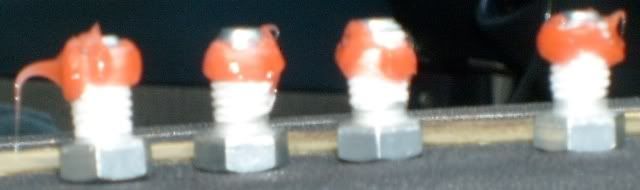

I wrapped them in Teflon Tape and put a ring of high temp RTV gasket maker arounf them:

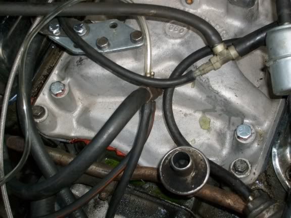

Then snugged them down in the intake. Tight, but not tight enough to strip the threads:
I started it up and ran it for about 45 minutes, letting it get good and hot. no leaks! YAY!
